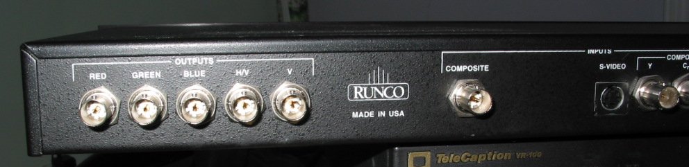

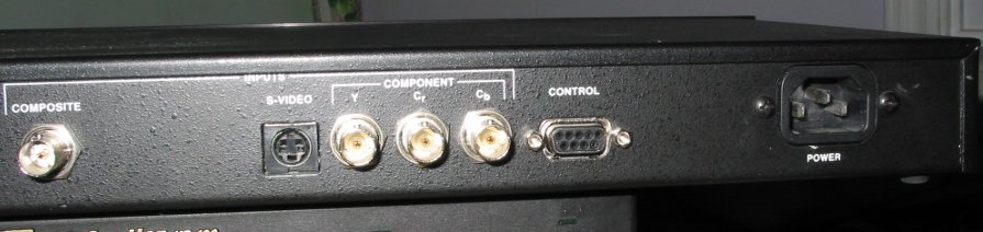

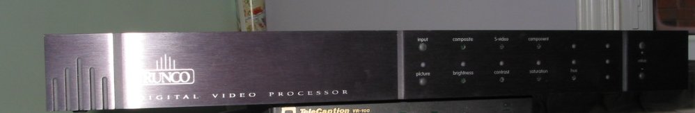

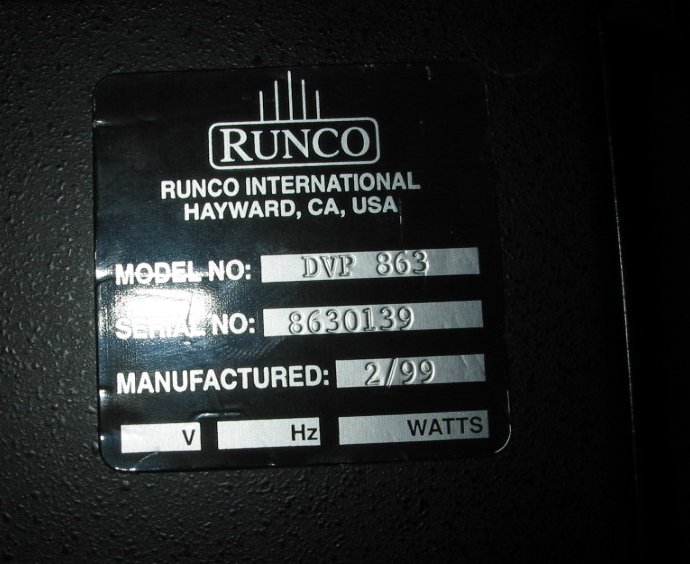

Ahhh bump, finaly got around to taking some picture's.
This has been sitting here since December and now I find I need it. Anyone got a remote that will work with one of these? Or the remote codes so I can make it work through RS-232?

Since Runco designed nothing, my guess is that it is a rebadged Faroudja DVP something or other. Label says 1999 so I would say start there and figure out what Faroudja made then and that should lead you to some manuals.

It'll be either a Super IDTV Runco IDP-900 (NEC PG 6000) or a Super IDTV IDP-900A (NEC PG 6100)
Both sets were also sold as bundles with line doublers.
Both of them were bundled with the SC-2050 scan converter though.
The IDP-800 (predecessor to the IDP-900) was bundles with a SC-1050.
All of these were introduced way before 1999

BTW, I just repaired one of those No remote needed, at least on mine. THe front buttons controlled everything.
The button to the left of the 'input' LEDs should scroll through the inputs. hold it down to see if it does.
Posted: Thu Dec 03, 2009 3:14 pm    Post subject:
Oh yeah I forgot to say....
This was a stores display model back in the day. They didn't want customers fiddling with it so they unplugged the internal cable from the front panel buttons so it would be locked on S-video.
