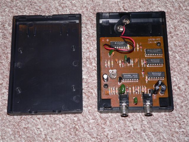

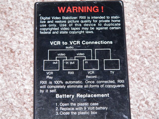

In the spirit of this discussion I just found this "stabilizer" that I bought back in the 80s.
 Filesize:  82.67 KB
 Viewed:  10253 Time(s)
 Filesize:  93.79 KB
Posted: Fri Nov 30, 2007 11:07 pm    Post subject:
Wow I have one of those but all the chip numbers were ground off. Funny I just found it half an hour ago too.

Posted: Sat Dec 01, 2007 2:57 am    Post subject:
Yeah, I only bought it because of the unstable pictures on my VHS tapes. Very Happy
Posted: Sat Dec 01, 2007 6:58 am    Post subject:
Right and I bought mine uhhh because uhhhh the Zenith 20" TV I had in the 80's didn't like the macrovision.
