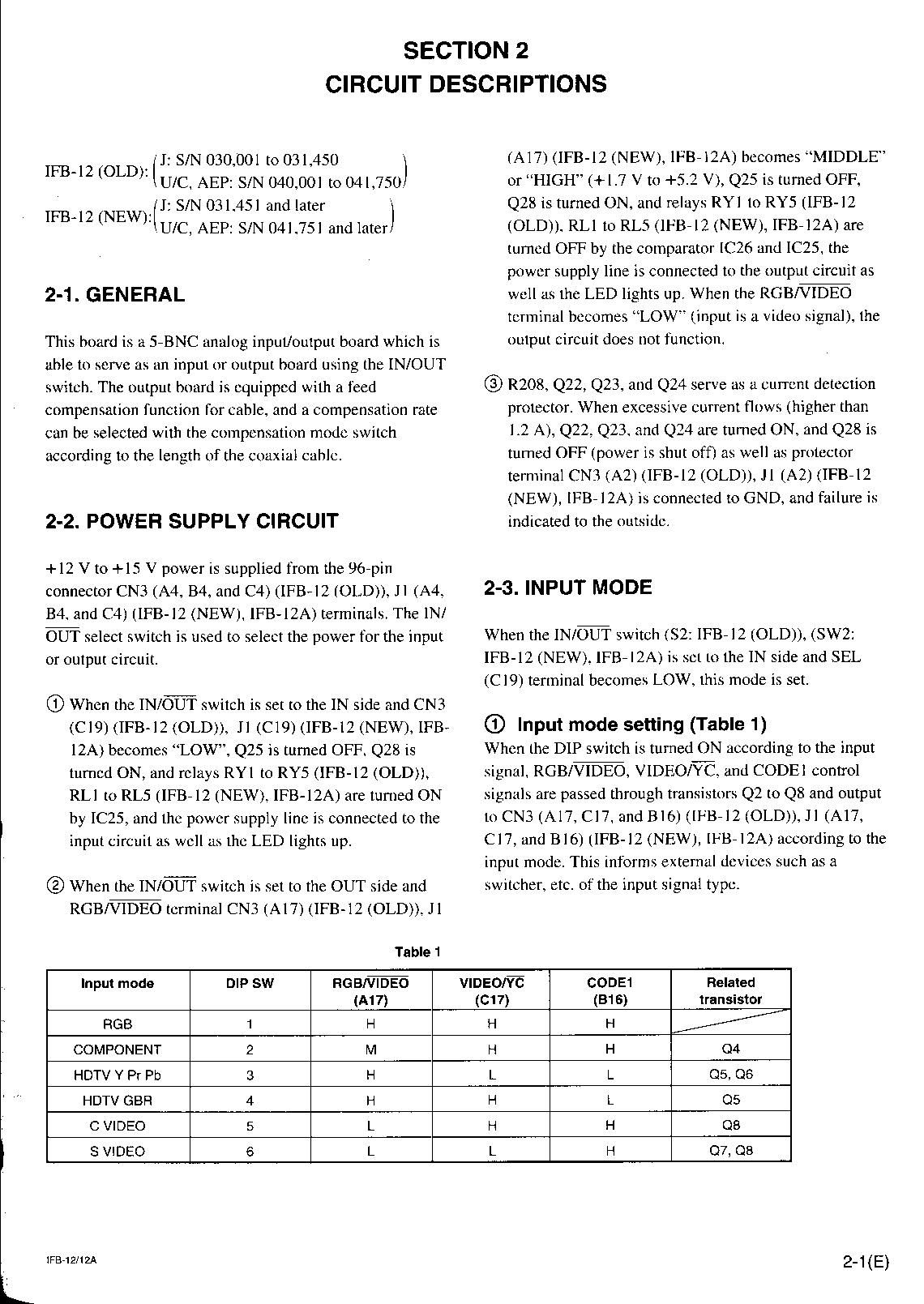

Reading about RGB passthrough in another thread just made me remember something I once read....
Doesn't one of the input cards for the Sony 12xx series have a setting to output the RGB signal to another machine? All I have are IFB-11's and one IFB-12. If this is possible in some way, it would make hooking up my stack MUCH easier... IF it is even possible to get the projector to send the signal back through the other input slot.

I read that the IFB-12A has a switch on it for that purpose. You can have multiple IFB's sending the RGB out to other monitors. I'm looking for it now.

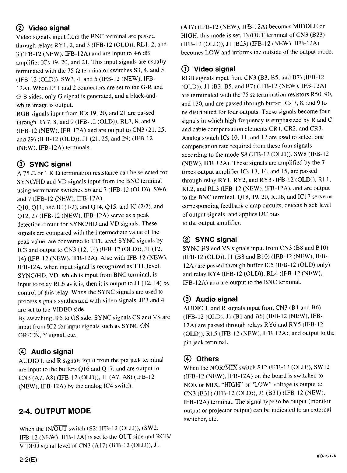

Posted: Mon Nov 26, 2007 8:00 pm    Post subject:
I think this is what your looking for. Apparently it is SW2. If the pic is not clear enough I will try to put a clearer one on. Good Luck!!!

Posted: Mon Nov 26, 2007 8:28 pm    Post subject:
I can read them just fine Very Happy This seems to be what I am looking for, and I believe that this is what I heard about Very Happy.
Thanks a bunch Thumbs Up
Now if the 1272 will let me use input B as an out that'll be great Very Happy
