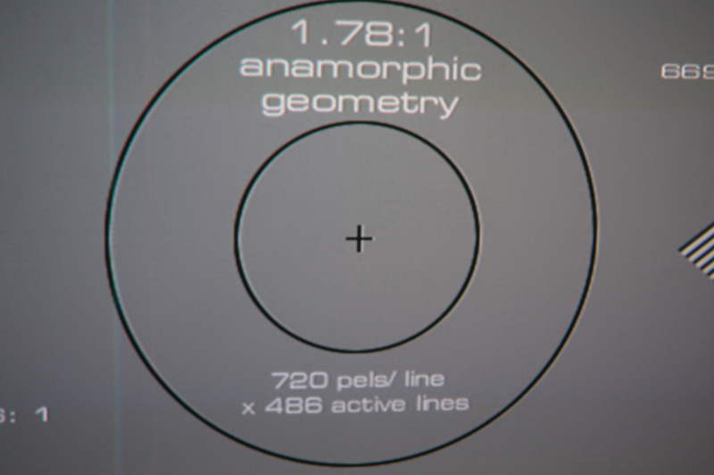

below is the ringing to the right of test pattern which appear on 1080p n 720p sources. Can anyone check and see if they experience this with the moome ext vga version. Does this appear on the BNC version? thanks.

Posted: Sun Nov 25, 2007 3:21 am    Post subject:
Try using a different image host, or attach it directly to your post. All I see is an add for the image hosting company.

Posted: Sun Nov 25, 2007 3:29 pm    Post subject:
i have made an attachment to my post earlier, please see post above.
