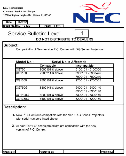

Dos this have anything to do with my control problem? My serial no is 3900217 A XG 1100

Posted: Tue Nov 20, 2007 11:37 pm    Post subject:
I think he needs to type in the service code and I can't remember it Rolling Eyes

Posted: Wed Nov 21, 2007 12:17 am    Post subject:
Did you check your port settings in your PC? If thats ok then it maybe the software is not compatible as the bulletin states for your serial number.
