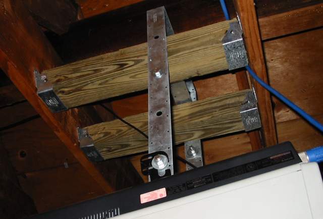

Anyone have an idea how to mount this thing? it just has those 2 hook-style mounts under it.,
jkruger
Joined: 24 Oct 2007
Posts: 2435
Posted: Wed Dec 12, 2007 9:05 pm    Post subject:
I used one of these to make an inexpensive mount for my first projector, a sony 1000q. It is a strap from home depot, I just bent it to fit the projector and nailed in a couple of 4x4's between the joists in the attic to hang it from. They usually have them hanging in a corner dislay on the lumber aisle. With this and some allthread and some nuts and washers I had it up in a couple hours. Under $15.00
MST37 37.5" 12-Gauge Strap, Model MST37, $4.93/Each
Looks like this:
 Filesize:  29.83 KB
 Viewed:  11436 Time(s)

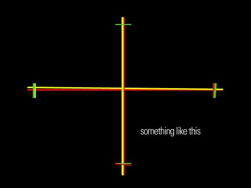

I knew alignment was going to be a total ****, but not as much trouble as I had yesterday.
K.
SO in all my faithful forum following i've drilled into my head that maximal rasters are what we need, covering most of the tube face. I peer down the green tube and adjust the V size (H size is maxed out) and that's where I made my fatal mistake. Green wasn't really maxed, but I resized it to be slightly more than about 95% of the tube face (no visible wear lines). So yeah, try and do the red, and the blue. Fine. I have them all the same SIZE............................
but the "squares" are not the same size (linearity) and convergence is sh*t all around. So I cut blue and focused on red and green. After about an hour I had them mostly on top of each other, except for the bottom right hand and middle of hte picture. I mean, twirling those pots left and right wouldn't make the damned lines line up. After about two hours I had most of the grid somewhat nice. Except for some slight registration errors on the top and bottom which are uncorrectable (pots are maxed out), it looked "acceptable." Then I turned blue on.... and did the same thing. After I'd formed a blister on my left thumb from fiddling with pots I had a watchable image. All of you could probably sh*t on it, but I think I did an "okay" job. 45 minutes into it I thought I was going to have to send the poor beastie out to Curt.
What would YOU do in my case, to get this thing aligned. Reset all pots to 50% and go from there? They don't have a mechanical detent in the middle.
I guess another question is, because GREEN is the reference, how do i know that the green values for the lineraity, skew, etc are within reach of the other 2 tubes to be corrected to?
approximately what it looked like

BTW i had the grid crosshatch up, but that would have been too much work to post. I figured that if i could get the red and green to align on the simple crosshair, I could work on the corners from there. No dice. I just worked using the crosshatch.
And another BTW... all the troubles started when I tried to follow the instructions pasted to the top of hte projector... It's kind of hard to do it with the lid on, since I found it easier to cut the blue and concentrate on red/green.
Posted: Fri Dec 14, 2007 2:15 am    Post subject:
Did you do the lens toe in first?
Fujifrontier
Joined: 20 Oct 2007
Posts: 354
Location: San Antonio, Texas
Posted: Fri Dec 14, 2007 2:40 am    Post subject:
ahm, ah... *ahem*... um, ahh...
*cringes*
What's that? I focussed the lenses using the nut that's closet to me. What's the second one, farther up for? Is that what you're talking about? I thought it was a secondary focus and adjusted it so the little dots were visible on the horizontal bars.
