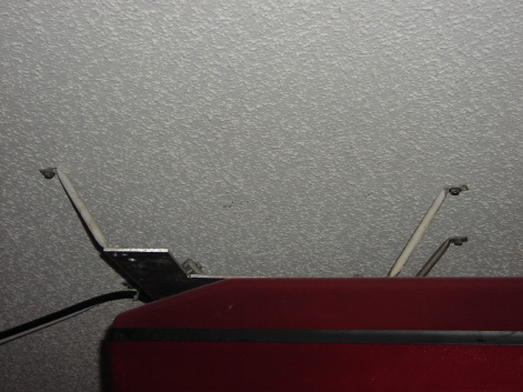

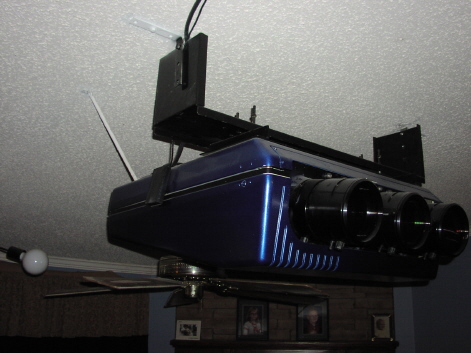

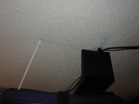

Robert A. Hill wrote:
That room is huge. Man, you have a LOT of equipment! Can you post some details on how you mounted your 4600 and 2600? Your efforts really make me want to get my 3600 off the floor.
The 2600 is held up by 4 pieces of 3/8" stainless steel thin wall tubing. With a lag screw through the end of each one straight into the roof studs. An aluminum plate is attached to the bottom of the tubes. The 2600 is attached to the plate in slotted holes to allow for adjustment.
That is the same mount that held up the 3600 before I changed to the 4600 in the theater.
The 4600 is held up with ONLY TWO 5/16x3 lag screws. They are in the L brackets at the top of the black mount, one on each side straight into the roof studs. The black mount came with the 4600. I have two pieces of the same tubing used on the 2600 coming off the back corners to stabilize it. They have one #10x1" screw in each.

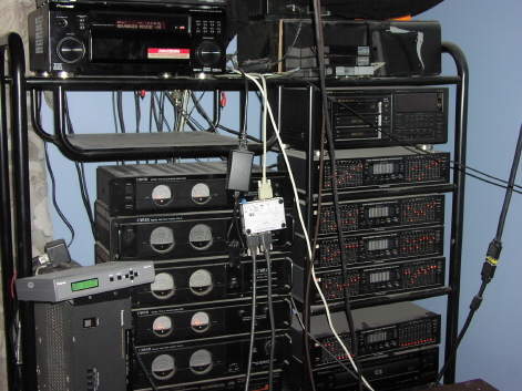

Posted: Sun Nov 18, 2007 1:47 am    Post subject:
Cliff,Curt Thanks.Very Happy
This obsession of mine MIGHT be the reason for $250-$430 electric bills. Shocked
I will take a pic of the front right side with the speaker moved so you can see more of the equipment. Thumbs Up I have been collecting equipment for a long time to get it this far. Smile

Here is a better pic of equipment.
