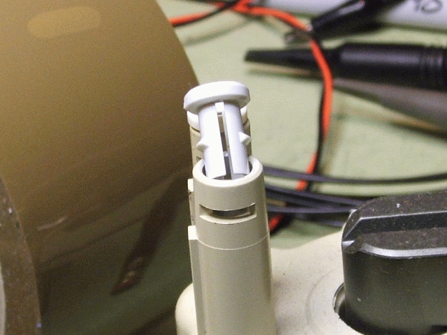

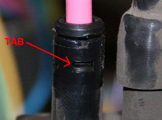

tse
Posts: 1014
Location: Sweatbucket, Fl.
Posted: Sun Nov 11, 2007 11:07 pm    Post subject:
It almost looks like there are some little tabs on the insert that holds the wire. If you can press them in (probably another on the opposite side?) the insert may come loose.

i think i f-ed up big time Crying or Very sad Crying or Very sad
I pulled out the HV lead like macguyver said.... but part of the little ear clip thing broke off and now is sitting at the bottom of the splitter.
I was scared shitless at this point, to see part of the clip gone with just that little snippet of wire at the end, so I put the HV lead back in and slipped hte boot back over it, and fired up the TV. It comes on, thank goodness, but now makes an audible sizzling/growling kind of noise at a low volume, and there are random lines that appear in the picture. I pulled the HV lead out and reseated it, hoping it was just making a bad contact. I hear the sizzle from the HV lead itself, like pressure escaping from a tyre that's been dunked to check for flats. When I pulled the lead out, I could hear the pzztfftttt coming from the end with the little wire. The TV still makes the noise and there is a picture disturbance; the 16khz whine is also a bit distorted... I didn't leave it on too long because I know that maggies are notorious for blowing flybacks.
what do i do?>
Sad Sad Sad Sad Sad
Posted: Mon Nov 12, 2007 12:26 am    Post subject:
Looks like oyu have toget that little piece out of the bottom of the socket it fell into. Its probably frying away in there. Lots of voltage going through that wire!!! try using long needle nose plires but make sure he tv has been off for a long time there might be some voltage left in there.
Posted: Mon Nov 12, 2007 2:11 am    Post subject:
Wish I saw that pic first. That flyback is different form the one I described, but I have broken those clips off before even when pushing in to remove. They are very fragile. Try using a vacuum to get the piece out, or something sticky on a pencil eraser. Make sure tv is unplugged when doing this. After you remove the piece the wire should now go all the way in. The one remaining clip should hold it in place with the boot. After you assemble it and before you plug it back in, tug on the wire slightly to make sure it is holding. If it seems to pull out you can use a couple of nylon ties to hold it down.

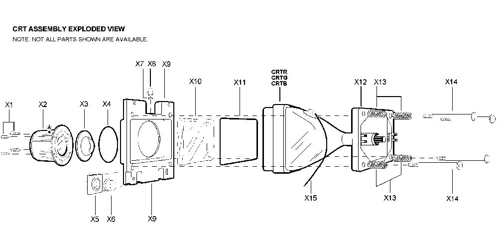

Hey mcgyver...
When you did the coolant for your Maggie, did you loosen the 4 big hex bolts and disassemble the CRT like it appears in the service manual, as attached?
All I did was drain the coolant, filler'up and put the tube back in. I was very very scared of a few things, namely knocking the magnets out of place even by a hair, getting glycol inbetween the lens coupling, and getting glycol on the yoke or anything else, but I really wanted to clean the tube face and internal lens face of the crap that had built up inside it.
No one scream at me... The lens element was never touching the floor. FOr whatever reasn the green lens is much more recessed than the others, and it has little plastic tabs that keep the lens well away from the floor.
If i loosen those screws, where is the glycol going to leak first?
