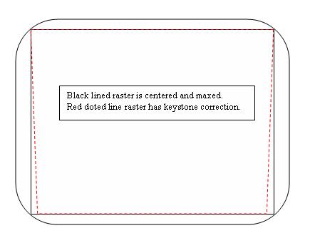

I have read a lot about how important it is to get the raster perfectly centered and maximized. I think I have done a pretty good job of centering and maximizing, but after doing the geometry I noticed that because of the effect of the Keystone adjustment (smaller width at bottom than at the top), that I could move the raster down some more and then increase the raster size even more. So before keystone adjustment I would have all four corners of the raster almost touching the corners of the tube, and after keystone the top corners are still almost touching, but the bottom corners far from the edges of the tube. So if I move the raster down, I can increase the size of the raster quite a bit more.
So my question is, is it more important to have the raster center top to bottom or is it ok to move it down and maximize the phosphor use. I am guessing it is probably better to keep it centered (seems like it might be easier on the electronics). I am guessing that during Guided Mechanical Setup, when you are moving the raster’s around on the tube face that it is actually the static convergence that you are using to move them.

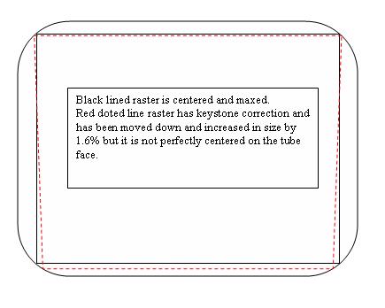

I have the projector above the bottom of the screen right now. So I have the back of the projector propped up. Since the Marquee has 10 degrees built in, I am probable only running about 7 degrees. Which means very little keystone.
But just a little keystone can change how much you can increase the raster size if you move the raster down some. See the drawings below. By decentering the raster you can actually increase the size by about 1.6 %. on a 100 inch screen this is 1.6 inchs, a significant difference.
Everything I have read stress centering the raster on the tube face, so I am not sure making the raster a little larger is worth not knowing how it might effect the picture.

Are you actually running a 4:3 raster? I generally center my raster with a 4:3 (because it's easier to see it's centered with a full-size raster), then I squeeze it down to a 16:9 raster for actual setup. And with 16:9 you can run it a bit larger because you don't run into the corners.

On a Marquee with linearity controls you really should center the center of the #-hatch on the tubeface, not the edges of the raster to the edges of the tubeface. Done properly the raster will always stay centered even after adjusting linearity.
The main reason to having the center of the raster at the very center of the tubeface and not move it because it's possible due to keystone-geometrics is that the picture will always be at its sharpest at the center, due to properties of the optics and spot sharpness/shape, at which point the eye focusses and the action for the overwhelming part takes place.
