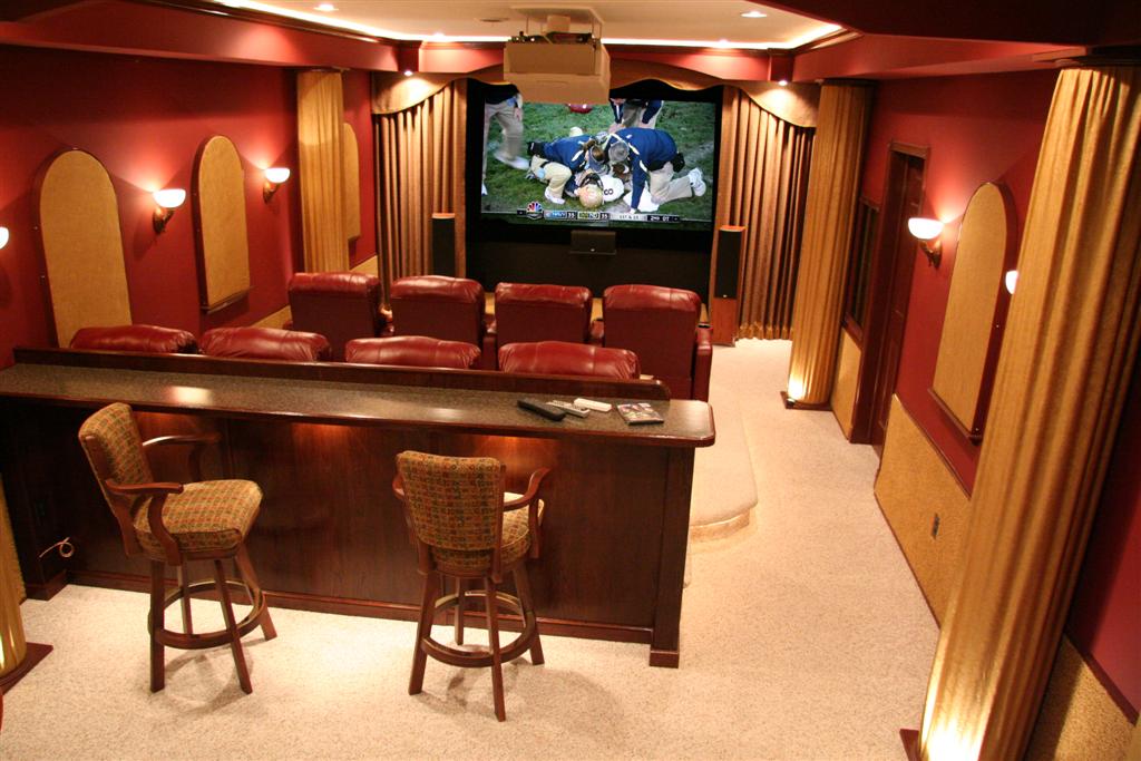

Took about five months but I finally finished the seating in the theater. 8) 8) It was more involved than I thought. Carpeting was tough...didn't know you couldn't bend Berber easily. The counter was all made from scratch...2x4's w/ oak paneling stained like mahogany...underlaid with drywall and stuffed w/ insulation...solid. Under-counter lights are dimmable! Risers are stuffed full of insulation for dampening. Prewired for Buttkickers. Rock & Roll!
That's an actual screen shot but I had to drop it in to get the exposure...

A question. The frames with the rounded tops that are mounted on the walls. Are they to mount posters to or just decoration?

they look like sound treatments to me....

Those are actually sound treatments as zaphod correctly noted. The construction details can be found in my photo album. They are cloth covered insulation panels that are spaced off the wall about 1/2" and sealed to the wall with silicone. Big dampening "drum lids" basically. The lower part of the wall is covered in carpet for add'l acoustics.
Incidentally, I do also have poster-mounting panels going up the stairs. You can find details on those as well in the album. Please feel free to ask any questions as I would be happy to reply with whatever I may be able to help with. Goodness knows this forum has helped me enough! 8) Smile 8) Smile
