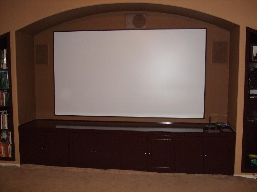

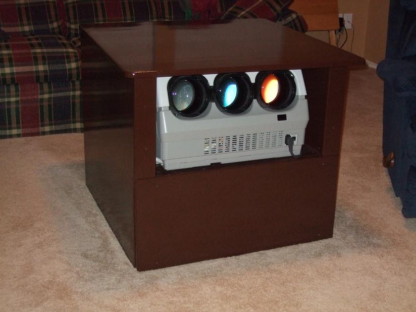

I have mine setup on the floor due to having a high ceiling, the mount would have to hang down quite a bit. I made my own table for the pj. I had to elevate it some due to my screen being about 2 1/2 feet off of the floor. Here are some pics.
[/img]
I've never heard of someone claiming their ceiling was too high to mount a projector. I mean, those unistruts and threaded rods can make almost any residential ceiling a breeze. I guess maybe if you were living in a loft with ceilings above, say, 15 feet or so, but anything seems manageable.
I have a 15' vaulted ceiling in the room and just didn't think it would look attractive hanging down that far. I would have also had to get rid of the ceiling fan which I did not want to do. It really works out well having the pj table there for drinks, snacks and a place to put the remotes.
