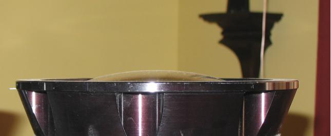

The 10F lenses are sharper than the Gt17 lenses. The 10F lenses would be better for blend setups as the corner focus is very important. I've had both and done direct comparisons. But I have a personal preference for the GT17 lenses over the 10F......The profile of the curved first element of the GT17 and the 10F is different. The contour of the GT17 first element better matches that of the c-element, reducing reflections back onto the tube face and back to the screen. This effectively reduces that contrast ratio in scenes with both bright and dark content. The reflection is centered around the center of the lense. Anyone with a Windows based HTPC can easily test this. Use the screen save that brings up the small windows logo and moves it around on a black background. If you look into the lense you can see a reflection of the windows logo on the tube face directly opposite to it centered around the center of the tube. If you have a fully light controlled room you can also see it on the screen as a brighter spot on the screen.
I've never seen an HQF 900 lense to compare the first element profile to that of the 10F or GT17, maybe Mike Parker could pull one of these HFQ900 lenses and take a picture similar to the one I have attached of a 10F lense. The GT17 first element protruded from the rear of the lense almost twice as much as that of the HD10.
