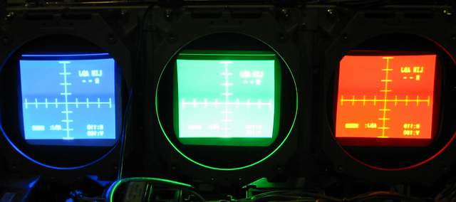

I have remounted the tubes with springs and grommets for the mechanical convergence mod and opened up the raster. After doing the mechanical convergence it seems that the red lens is angled inward so far that the cover will not fit well (pushes out on the red lens) and the springs on it are at the end of the usable travel, almost no pressure on the crt. Has anyone ever run into this and what could be causing it? There also seems to be a curve in the green along the lower right edge.

1. I think you should make those raster sizes just a little smaller, you are really pushing it to the edge there. That will probably fix the green corner issue.
2. The only reason I can think of why the red is angled in so much would be that your projector is not square with the screen, causing you to angle the red more. You might think it's square, but there are many variables that could affect this. like maybe the wall your screen is on is not straight.

Did you try resetting all settings and starting again from scratch?
Your G2 or BIAS is too high, you should'nt see rasters so bright.

I turned the brightness all the way up to maximize the rasters per previous instructions, that's why it looks so bright in the photo. The internal test patterns are a little bigger than a projected image so I think the projected image in normal use will be a safe size. I rechecked the centering and squareness again with another person checking my work and got the same results. I think I will try swapping lenses around to see if it changes. The red lens has a serial number 250 digits lower than the other two which are only 3 digits apart. I don't think that would make any difference but it's something I noticed.

Okay, I swapped the lenses around, blue to red, red to green.. etc.. no change at all. The lens flapping ring on that tube was installed incorrectly when I got it and it appeared that someone had done a lot of messing around with it. Any and all suggestions are appreciated.

Read this post all the way thru http://www.avsforum.com/avs-vb/showthread.php?t=922925 This is a really good thread with great info. Also, you really need to read over, and over again the set-up info from Curt's site.
You will need to adjust the yoke on the red crt to get it sqaure with the green.

Okay, I found it. I reset the red zone to factory spec and it's fine. I thought I had reset them all before. On to the next phase. Embarassed

can the yoke adjustment affect one edge of the raster like that? I thought it said the yoke would take care of rotational orientation of the whole thing. Question

No, it will only adjust the rotational orientation as you say.
