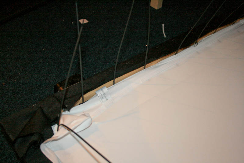

Then I installed the Seymour, and during some tests I noted that around the frame where the screen was folded and touched the screen from behind, the image was brighter since the holes have a white surface behind.
So I buy a white bed sheet and installed it very very behind the screen, in a very tensioned way. There is, say, 0.2" between screen and sheet.
Of course you'll say that white behind the screen is evil. Yes, if you have a white wall behind the screen, the light that passes throught the holes will reflect all behind the screen, killing contrast. But if you put a white sheet VERY behind the screen, the light will refect just from it came. It's just my opinion, I could be wrong.
I did not made tests (the screen was heavy and I was alone) but I just noticed the same light than before, no more holes and very good white balance.
So I'm saying: try a white sheet behind your seymour screen. Then a black sheet behind everything is correct (I have black velvet to the walls).

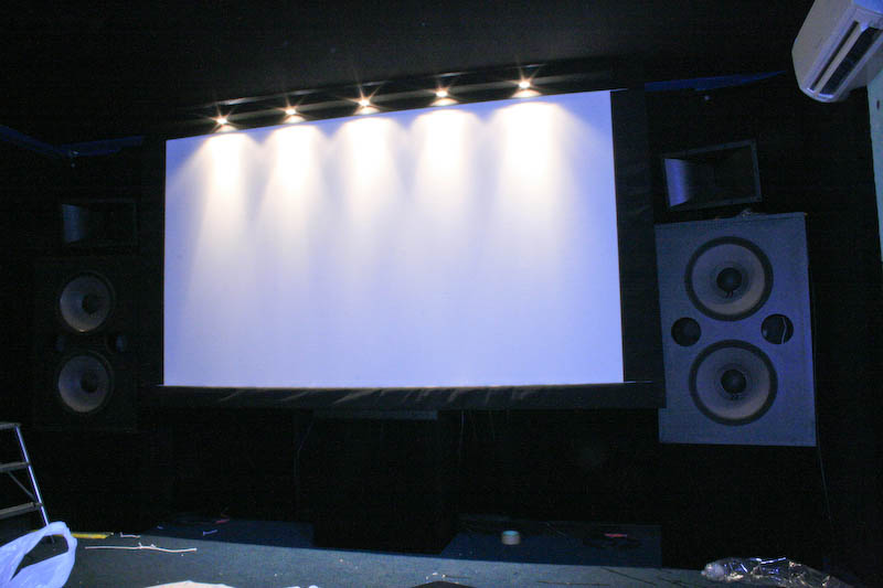

Finished screen. I fix that weaves in the black fabric below.

White sheed tensioned just behind the screen

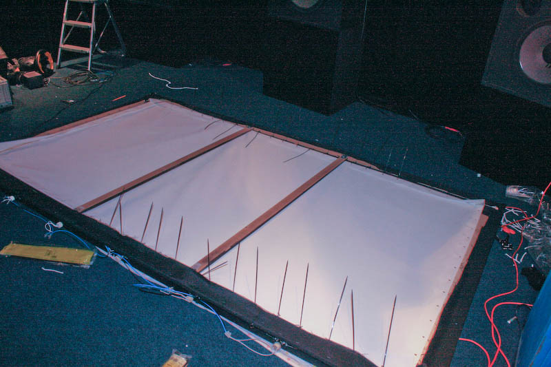

detail of white sheet

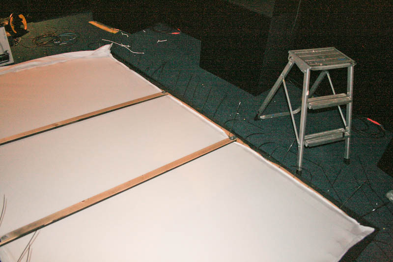

New screen tensioned by cable tie

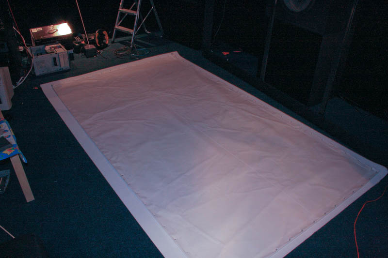

old screen on the new one. The reddish tone is made by incandescent light, the old screen was very white!
