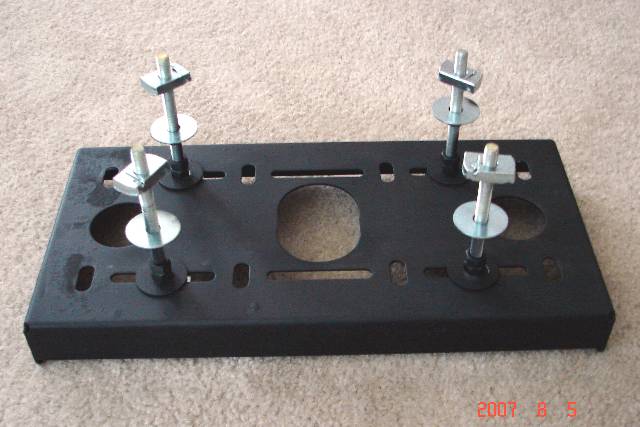

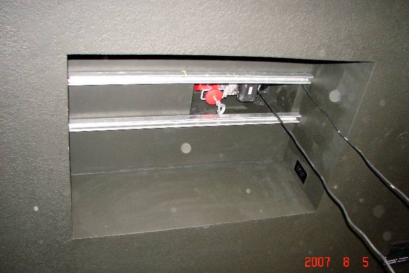

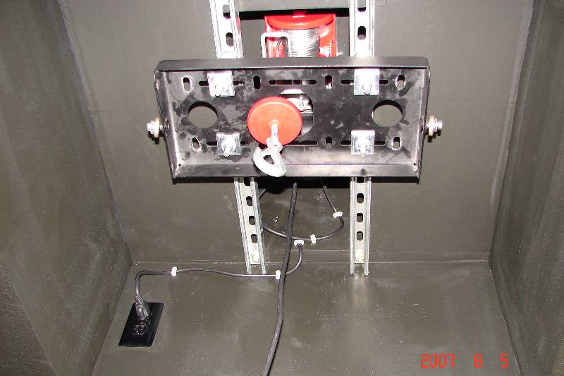

I recently did the same thing with my 9501. The only difference is that I mounted a hoist in the ceiling. I believe my screws are about 13" apart and everything is fine.
 Filesize:  40.25 KB
 Viewed:  2701 Time(s)
Ceiling box with hoist and mount just waiting for the 9501 to be raised.
 Filesize:  52.97 KB
My ceiling "box" and "box with-in a box" showing the hoist and unistrut.
