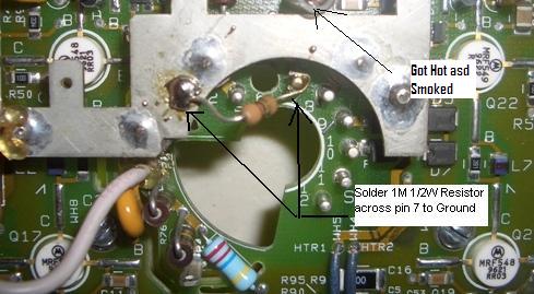

Well I pulled off the neck card off the blue tube and found the culprit. It was a capacitor that was added to my neck card when Greg E. did his mod. It got hot and burned the foam that is glued to the aluminum neck card cover. I replaced the modded capacitor with a surface mount one from a salvage neck card I have and redid the LUG mod to include the 1M Resistor as pictured. Everything seems to be back to normal for now. I will see what happens when I try the BLu ray from the PS3 again.

Was it a surface mount tantalum cap? If so, they can simply just short out and blow up.
But it WAS a cap!!

Caps don't usually get hot and if they do then they usually blow up soon after they get hot. Are you sure it wasn't a resistor? One of Greg's mod hey, hmmm.
