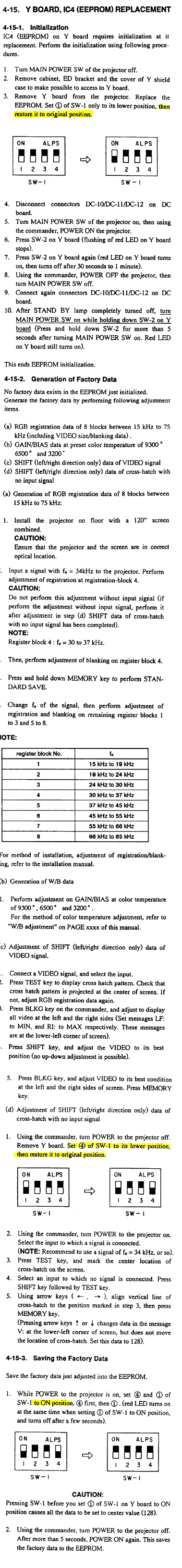

Ok Guys
I'm still stucked with that 1271 and I don't want to thinker with the switch and buttons until I'll very sure on what I'm doing.
For your convenience I put toghether in a GIF the Service manual pages where the reset is explained.
Can someone help me? Seems that something is wrong, Sony say to move the dip switches and restore it at the original position every time. However, on the last step, Sony asks to put the switches 4 and 1 on ON position, but from previous step they has been restored to ON position...
Suggestions?
Ciao
Antonio
