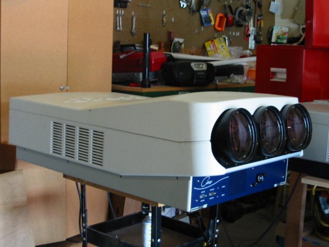

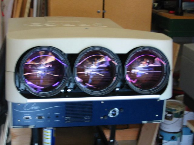

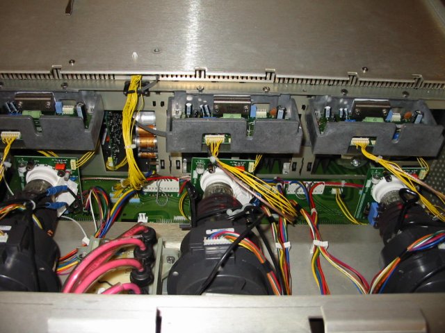

I started transforming my Cine 8 to use rebuldable tubes. With the BG808 as a donor machine, I have sucessfully transplanted the BG808 tubes and neckboards into the Cine 8. And it works. Case repaint in the future and when I get some new tubes, it should be a great machine. now if I can only make room for it.
Photos in my album.

I want to be like Curt when I grow up! Got no theater, all projectors broke.

The only problem I see is that those RGB neckboards from the BG808 are older and a step backwards (75mhz) then then ones in your Cine8 (120Mhz).
Of course, if your original Cine8 tubes were toast, newer MEC tubes on 75Mhz neckboards would look better then toast original tubes driven by the 120Mhz neckboards! Smile

Yea, the tubes are past toast. I'm hoping I can modify the original neckboards to work on MEC tubes then reinstall them. But for now I just wanted to swap over the tubes, magnetics and associated RGB hardware. I put the Sony tubes and magnetics in the BG808 but something isn't working right. It will power up then shutdown again.
As soon as I can get some tubes I'll put up screenshots.

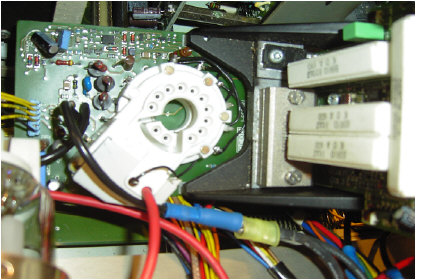

I have gotten pm's from people to provide more info so here it is. The picture will be coming later because I am having trouble with the downlaod. Most of the socket pins have been cut but a few blanks are left alone. That keeps the socket secure to the board. The pinout of the 180DVDB22 is:
1=blank
2=blank
4=blank
5=G1
6=G2
7=blank
8=cathode
9=filiment
10=filiment
11=G1
12-G1
13=blank
Pinout of the 180DMB22 (Marquee tube) is:
1=blank
2=G2
4=blank
5=G1
6=blank
7=blank
8=cathode
9=filiment
10=filiment
11=G1
12=G1
13=blank
Pinout of all Sony (either 8 or 9") tubes are:
1=G3
2=blank
4=G1
5=G2
6=filiment
7=filiment
8=blank
9=G1
10=cathode
11=blank
12=blank
13=G1
If in doubt, you can always look thru the glass to see where the different elements actually hook up to the socket pins. This info I provide is for a courtesy, I can make no guarentee about your results.

Posted: Mon May 01, 2006 9:30 pm    Post subject: Picture of the 120Mhz modified neckboard
I finally got the bit size low enough to download.

Yes, I have the 75MHz boards that unmodified work with MEC tubes. If you want to trade me your Cine (Sony) neckboards for them just let me know.
