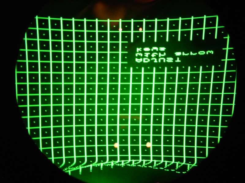

Hi guys,
I just upgraded my BG808 with the newer conv.driver board (R7625189), COG module (R762819) and latest software V6.30 in order to enable left side, seagull and horizontal linearity controls.Everything is recognized in the menu, i even see a increase in sharpness (dots in the crosshatch pattern), but.....
The bottom of rasters are bended on all tubes and i'm unable to adjust them with raster shift or vertical size.
Does someone knows what should i do ? I taught that all settings are kept except convergence, if conv. driver board is swaped...
Thank you, Stan
