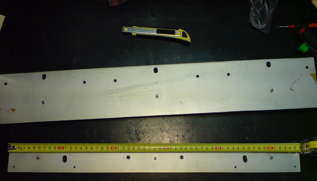

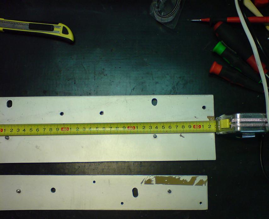

Spotmatic wrote:
Here you go Mr. Green
I got one set that Ile made..
But i think you guys should found "original" drawings for those. It can be triky to copy dimensions at those plates that i got

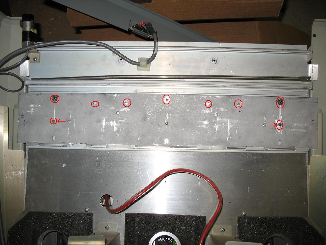

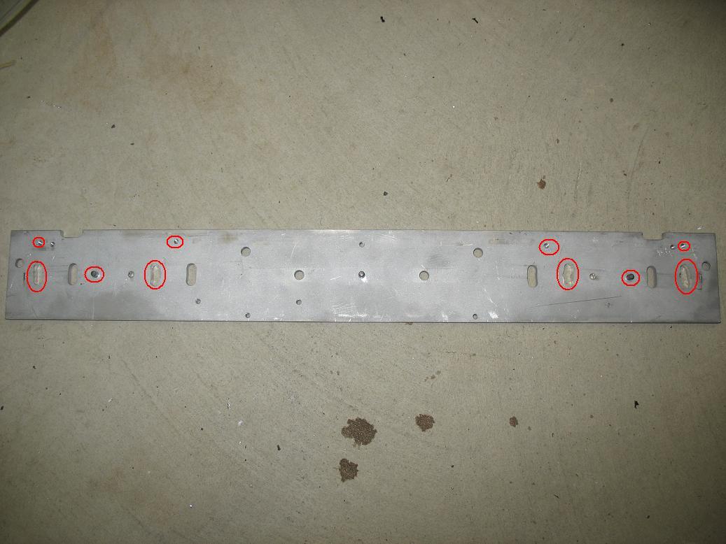

Here is a link to the original thread;
https://www.curtpalme.com/forum_archived/viewtopic.php@t=4545.html
Chris.
