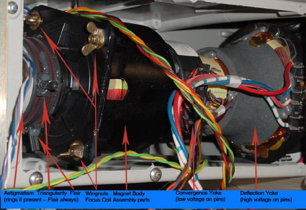

Really it's not a 100% deal, not even if your magnetics are properly set up.
But... if the magnetics are nice & tight, then the HELP menu's will get you pretty close to where you need to be!

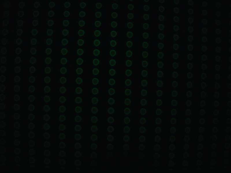

Do you get any flare? Turn up your contrast to 100, set focus to 0 and put up the dots internal pattern. Are the dots round, oval, or do they have any flaring? Flaring would be like a tail or something. If there is no flaring, then you can get a halfway decent pic. But for optimum, you'll want to spend a few hours getting those magnetics setup properly before you even bother with the HELP menu's.
See attachments for magnetics stuff.

This is what the EDIT: BLOBS!! should look like. If they aren't similar to this, a nice little (but not perfect) donut with an empty center, then your focus will not be optimum.

I have a small dot in the center but overall round outside . How close is this to right ?

Those dots look completely different than what I have on my 8000. I've never messed with the magnets but I have small dots (solid dots) with no hole in the center.

Sorry guys, I always get it backwards. Very Happy
Ramp focus from one extreme to the other please. Laughing Smile

Contrast at 100, focus at 0 should give lines and dots with bright "core" in center of out of focus area. Ramp focus up to 100 and dots should look like the ealier post.

Hello again to all. CZEDDIE - That was a great post on your behalf so Thanx very much for having responded. I proceeded in performing the exercise which you outlined and I seem to have a roundish looking sphere with a dot in the center; Is this okay? This projector was originally set up at 109 inches away from the screen and now I have it at approx. 120; How much of a radical change is this in terms of distance? In other words, is it enough to require a readjustment of the magnetics? Thanx folks Smile

The adjustments people are talking about here (adjusting the CPC magnets to get the flare &etc right) are done with one color at a time. Done right, it gives you the sharpest focus. (Along with magnetic focus, optical focus, flapping, etc.) Once you have the magnets adjusted, then you can worry about things like converging all 3 colors together.
The CPC magnet tabs are on the rear neck of the tubes. There's not too much to worry about back there. It's up by the bell of the tubes that you have to be veerrryy careful.
