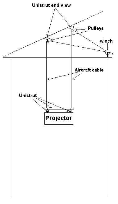

Posted: Wed Sep 19, 2007 7:47 pm    Post subject:
Here is a quick drawing of what I was thinking

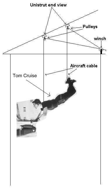

Posted: Wed Sep 19, 2007 7:55 pm    Post subject:
I like my idea better....
Mr. Green
 Filesize:  31.57 KB
 Viewed:  11497 Time(s)

You could probably build some sort of floor stand that would go under the projector to hold it still while you do the setup. Unless you had an air vent blowing directly on the PJ or had a large thunder storm I don't think that it would move much during normal conditions.

I agree with Steufel. It sounds like you are going to end up with a spiderweb of wire, cable, and fishing line.
I am not a structural engineer, but if you decide to pursue this make sure the four wires attach to the roof joist panel points (I'm assuming your roof is pre-fab engineered roof trusses), not in the span between the panel points (the panel point is where the diagonal bridging between the ceiling rafter and the roof rafter meet).
dbaisey
Posts: 821
Posted: Thu Sep 20, 2007 8:21 pm    Post subject:
I agree also with Chip. If done right a welding shop can make up a mount that cosmetically would look good. Done a few like this. Also its more comfortable sitting under when you can see something that will actually support it. You need to take into account that it will be like a clock pendulum in a earthquake so the tie in at the structure needs to be a good one. Not seeing wires shows some thought. You can paint to fit in with the back ground. Just my opinion. Doug
