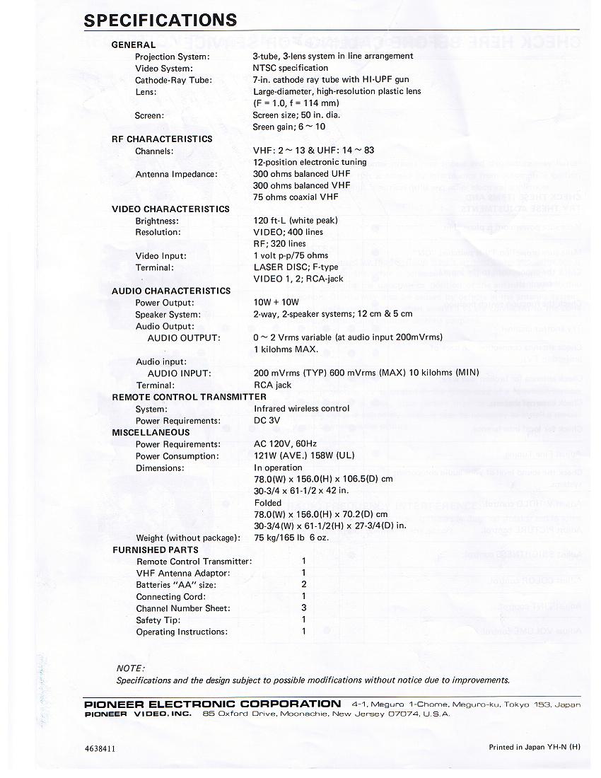

picked up local today. somethings wrong with the control board. power button does not fire relay to power up unit. i have manually fired the relay and it powered up. has built in tuner and was able to tune in water world. any thoughts on its worth? only has composite, lazer disk rf, and standard def tuner.
