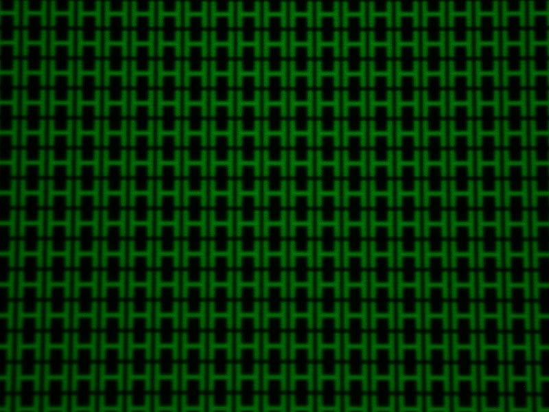

Those dots on H letters dependts what resolution or aspect ratio you use. Usually att those hours of use on tubes, you can see invidual dots only at 480i/576i.
Trye plug composite or S-vid. and put that H- pattern on and if you still dont have invidual dots Rolling Eyes then i would say something is wrong.
That is how my old 1272 did that H-pattern with hd-145 lenses 567p@50hz 16/9 unknow tube history? probably over 5000 hours on tubes.
 Filesize:  76.44 KB
 Viewed:  12782 Time(s)

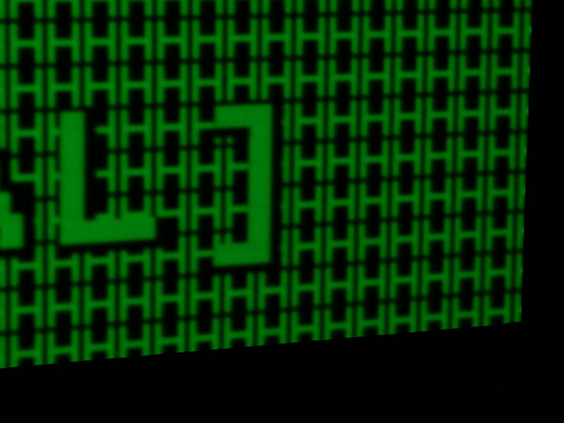

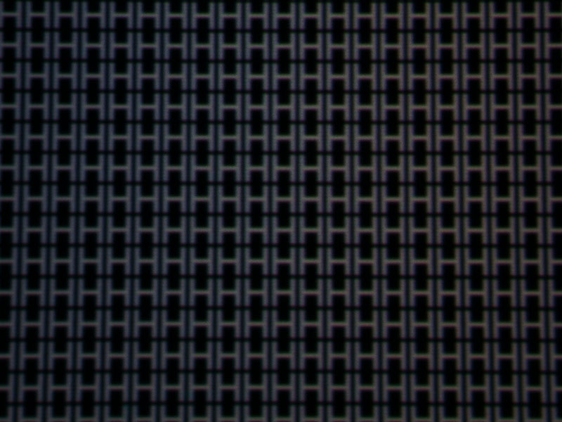

One thing more to add to this "dots on letter H" thing. i have owned just one 12xx series projector(1272) So Iīm not 100% sure but there can be different software versions on Y-card or different Y-cards. Y-Card makes those internal patterns and those patterns can be different depending what model or what verision you have. Maybe Sonynut have more experience is there difference on those patterns?
Here is one more for comparation.
 Filesize:  51.73 KB
 Viewed:  12691 Time(s)

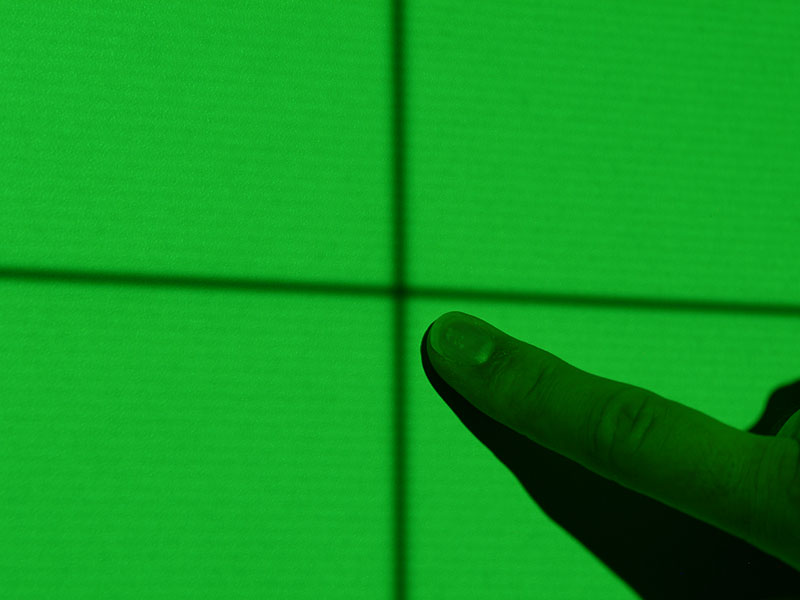

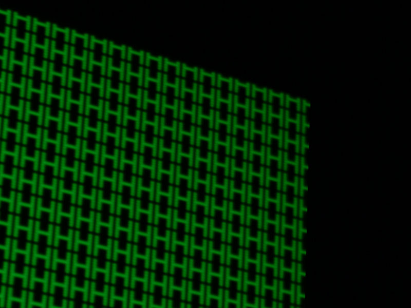

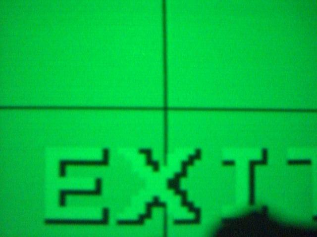

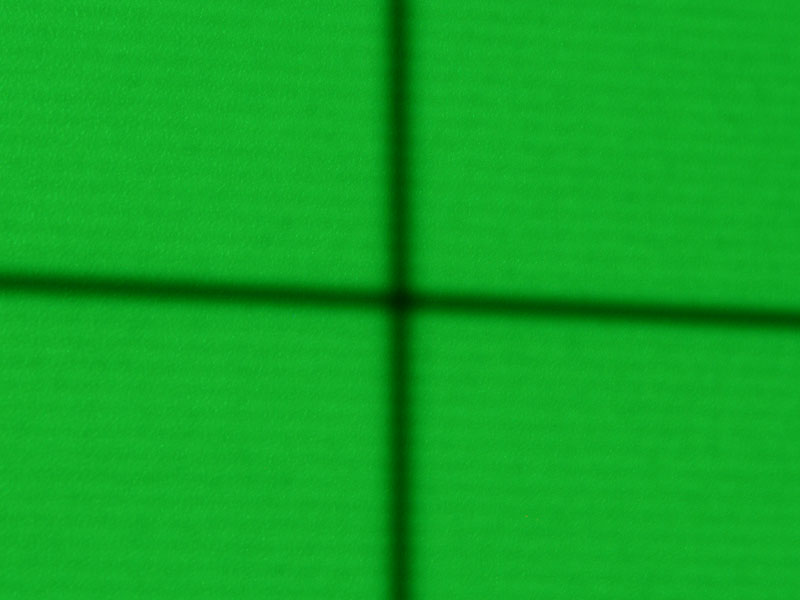

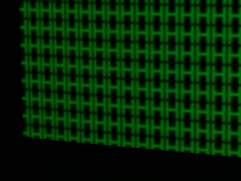

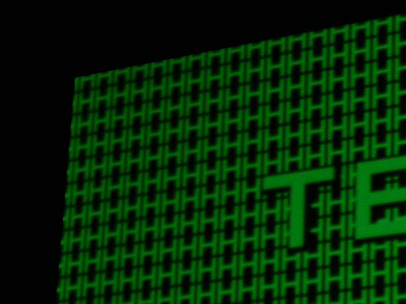

OK, here are my test pattern sharpness shots. This is my good old 1271 w/about 2800 hours on the tubes. Very, very light wear - probably 9-10 all across. Ceiling mounted, dead-on physical setup, and decent mechanical and electronic setup.
Screen is 96x54, WilsonArt DW.
I'm no expert, but I'm pretty obsessive compulsive about image quality being a design/photo/video guy. Let's just say I'm pretty damn anal and leave it there. I went a little conservative on throw/raster max for better uniformity and corner focus, and I think it might have paid off. As you'll see, my bottom corners still need some work. I haven't even done the mooneyass mods yet, but I think it's a damn good image for a projector this old.
These were all using the internal sync signal, which I think is about 480p.
One good thing about these old 12xx's is that even when they're set up as sharp as possible, they're just soft enough at 1080i that it really looks "filmy". MUCH better than SD, but very "solid" - as in no gaps, lines, pixes structure, etc. Practically no scan lines visible, even right at the screen. Looks very film-like from the seating position. Saves lots of money on 1080p processors!
H's - screen center, all tubes on
 Filesize:  78.25 KB
 Viewed:  12651 Time(s)
H's - screen center, R and B muted
 Filesize:  96.37 KB
H's - lower left
 Filesize:  61.82 KB
H's - lower right
 Filesize:  67.54 KB
H's - upper right
 Filesize:  72.54 KB
H's - upper left
 Filesize:  68.91 KB

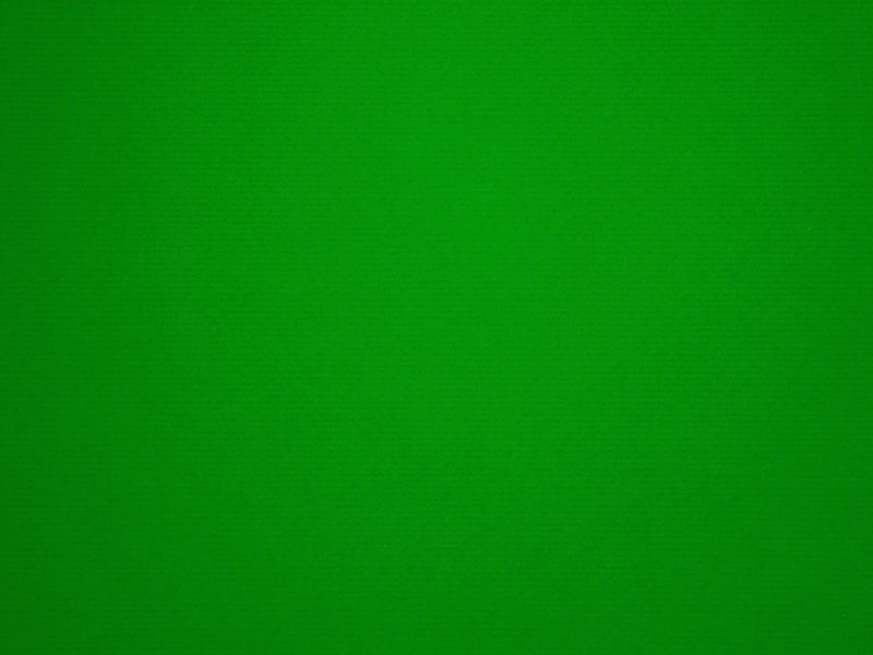

White field, R and B muted. 480p scan lines are pretty obvious near the screen, but not so much from 1.2x screen width seating position. Whites are where they become noticeable from the seating position.
 Filesize:  29.65 KB
 Viewed:  12652 Time(s)
Crosshair closeup.
 Filesize:  40.29 KB
Crosshair (screen center) with a digit for sharpness reference.
 Filesize:  43.06 KB

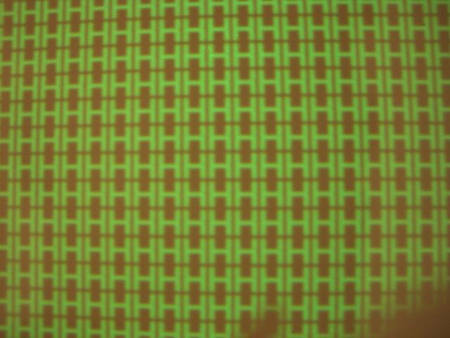

On a 1272 I had on my hands, I could saw easily dots with composite interlaced DVD source. Then, "H" dots were there, sharp and well defined. When running higher definition, the dots were not defined.
Check the photo, projected on a wall!!

Posted: Sun Sep 16, 2007 1:18 am    Post subject:
Tony,
OK, so 480i. Was that 4x3 or 16x9?
Nice dots. Wink

Hhhmm, those look really dog-gone good!!!
Sc, I see DOTS!!! Big time! I'll bet the picture is great as well.
Ciao,
I also see DOTS big time.
