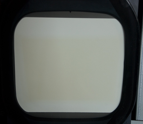

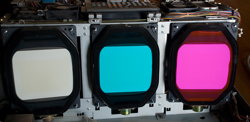

The tubes in this case aren't really minty, but they're minty's first cousin once removed. I'll let you guys be the judge:
(in case you're curious, I'd done the spacer mod already by the time I took these pictures...)
