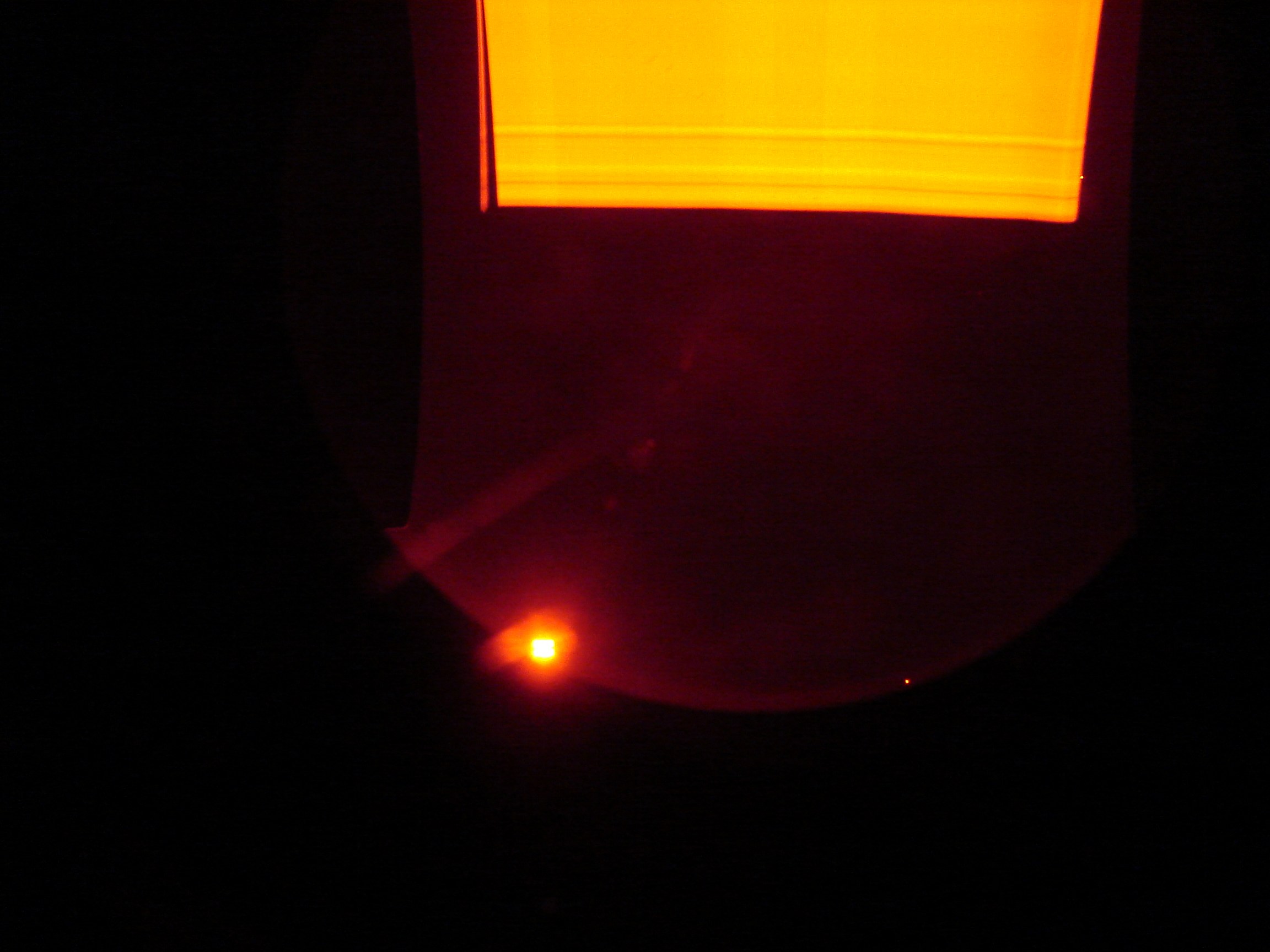

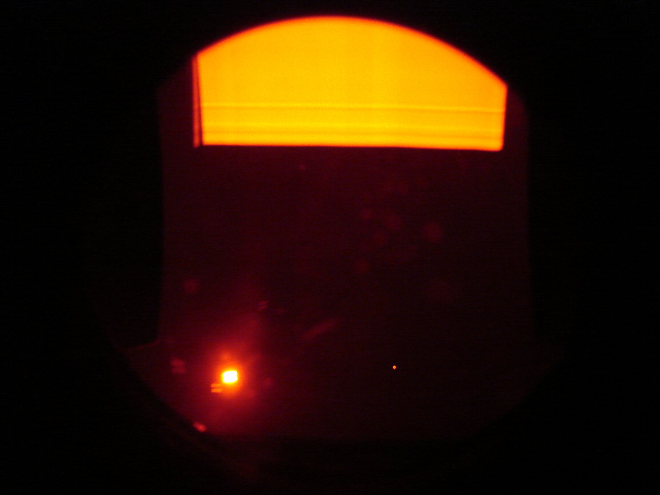

I've noticed that on black screens the red tube is casting a solid lit area. I've noticed it on the tube when a picture is shown where a good half of the tube has almost a backlit solid red color on a completely black screen.
Attached are two pictures of the red tube. The little light is the pause indicator the opposite of that is the solid red I was talking about on a completely black screen.

The pics don't make any sense to me...

Posted: Fri Aug 17, 2007 12:04 pm    Post subject:
Mark, the pic is of the red tube (obivously), the picture being projected is an all back screen. Under that condition the red should be fairly to almost completely dim, that is happening on half the tube. The other half is lit up. The picture is my best attempt to try and capture the event through the red tubes lense.,

Patrick12,
Im a bit confused by the picture but what happens if you take the Fury out of the signal chain or swap the red cable with the blue.
