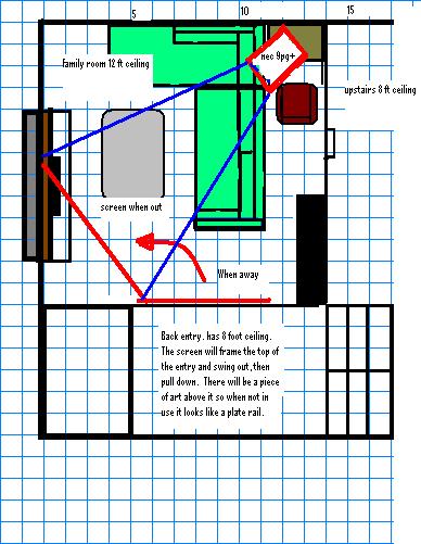

Posted: Thu Sep 06, 2007 3:10 am    Post subject:
Yeah, I'd like a permanent fix, but not in my living room. Roll up is my only bet. It should amazing when I'm done. Best of all, when it's not needed, it's out of the way.

Posted: Sat Sep 08, 2007 9:52 am    Post subject:
Mr. Green commented:
> Roll up is my only bet. <
Not necessarily. Even in your configuration, with the need to get it out of the way when not viewing, another option might be a swing-up screen on a solid panel (or stretched over a frame). It could be nearly flush to the ceiling when not in use, and the backing could be the same color as the ceiling, to blend in, or have some decorative pattern or weave. Then you avoid all the issues that roll-ups present.
Something to consider though, if not for you, then for others in similarly constrained situations.
