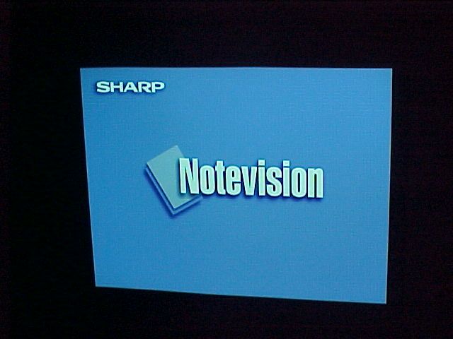

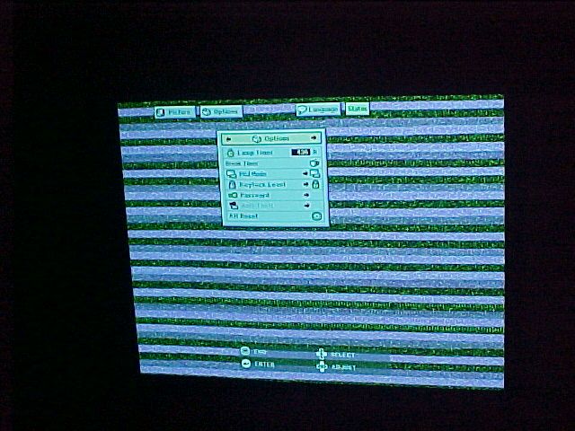

the menu shows up however for the image all there is is horizontal
black, purple, gray lines
is this an simple repair i can do with a new part and soldering iron
or is it a major fix?
attached are two pics of what the screen looks like
menu and horizontal lines

Since the OSD works, I predict it's just operator error or cabling configuration. Slight chance that it could be a video input failure.
1) have you ever gotten a video image out of it?
(did it use to work with your current connections or has it always looked like that?)
2) which video input are you using?
The PG-M20X uses a funky DVI 1.0 input cable (and they did not come delivered with the projector) for component and RGB connections.
http://www.projectorcentral.com/sharp_m20x.htm
Also note that the DVI 1.0 doesn't handle copy guarded equipment.
3) hook up something using s-video... does it work?

I'm sure it is repairable. looks like the input section. i've never opened one so not sure how repair friendly it really is. I heard they are pretty much made "disposeable" and not intended to be repaired. I'd give it a shot though.
