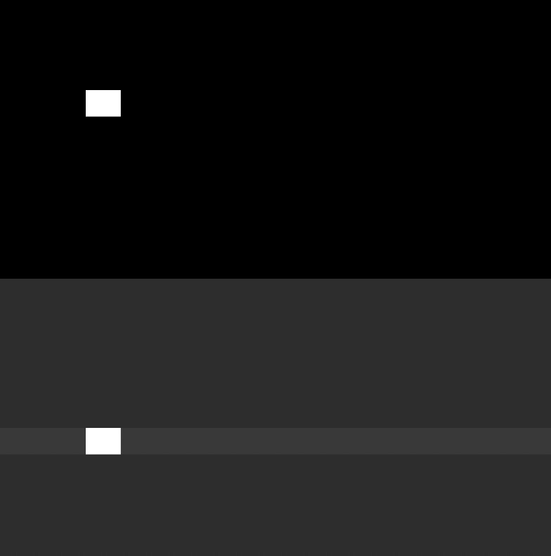

To address the streaking issue on the projector, I’ve read that recapping the neckboards might be the solution.
To clarify the streaking issue, a sample image to illustrate.
I’ve ordered all the capacitors listed in the service manual and would appreciate any tips from those who have done this before.
For instance are there other areas I should consider that could also be causing the problem?

Posted: Wed Sep 04, 2024 9:39 am    Post subject:
To add, on a full black background it doesn't show this behavior with a bright spot.
However on a dark gray background it shows the streaking on both sides.

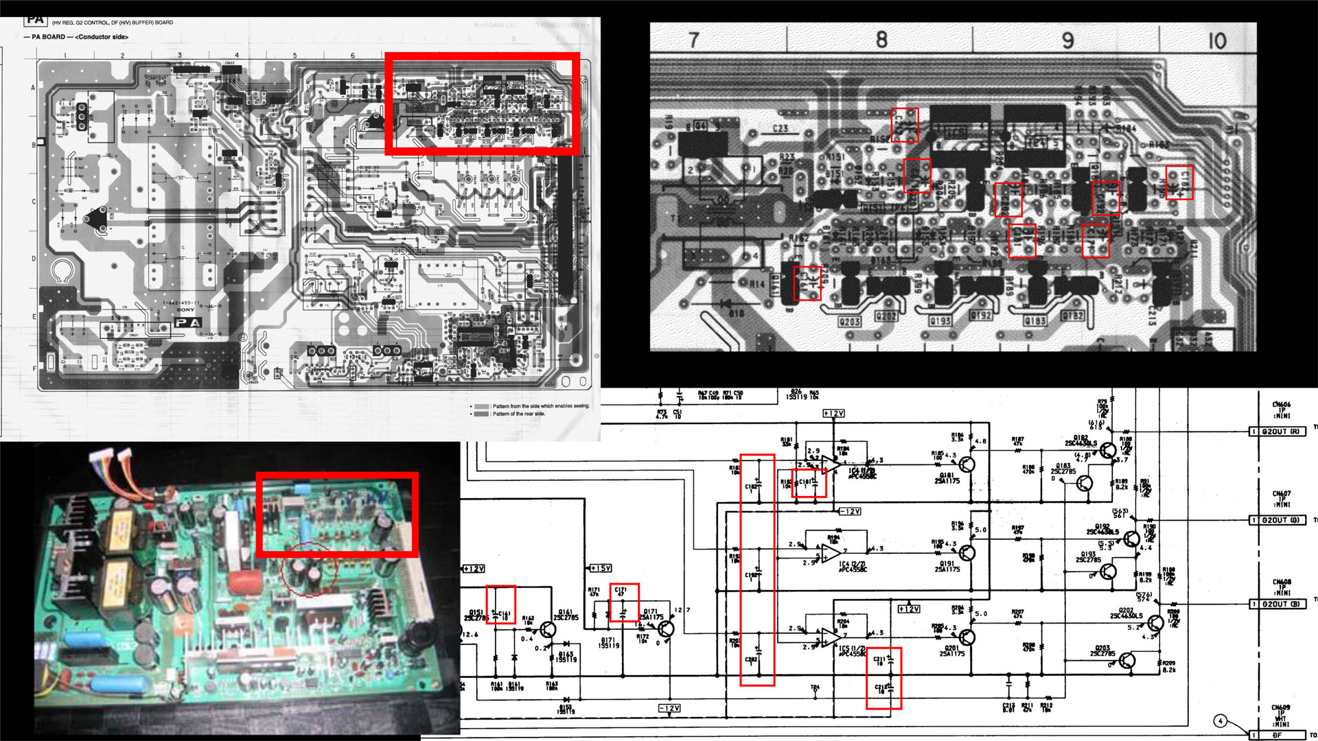

I took a look at the service manual and my guess it's about 8 caps that need replacing.
C161 10uF 50v
C171 47uF 50v
C181 1uF 50v
C182 1uF 50v
C192 1uF 50v
C202 1uF 50v
C211 10uF 50v
C212 10uF 50v
Maybe I can jolt a memory from either of you and can confirm I'm in the right area.
The image in the bottom left, red squared.
 Filesize:  467.36 KB
 Viewed:  1233 Time(s)
Dancrt
Joined: 16 Sep 2017
Posts: 88
Posted: Wed Sep 04, 2024 6:52 pm    Post subject:
Ah yes I think it was the little 1uf ones
Curt’s ones where slightly bigger and
I think I put slightly bigger ones again
Which solved the issue

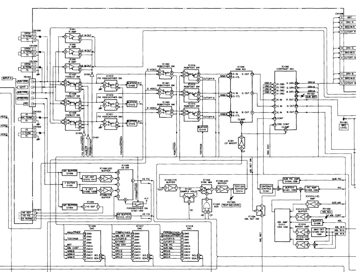

Would you have more information on the RGB switching chips? I tried searching, but nothing came up.
Any details on potential repairs might be invaluable for future troubleshooting.
I checked the A board diagram and I believe this part has the switches on it.
Any idea which ones were responsible for the cutting off?
 Filesize:  162.51 KB
 Viewed:  1206 Time(s)

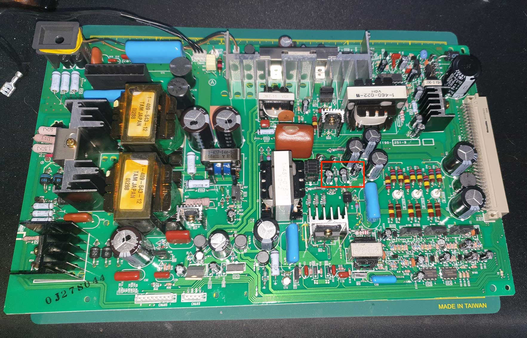

Before I start recapping the ones I mentioned before, here is a pic of the board.
The brown thing in the middle looks a bit iffy, like it has a blister.
I wonder if it has anything to do with the streaking, my gut says it’s harmless.
I’m hoping someone with more experience has something to say about this.
Thank you.

Dancrt
Joined: 16 Sep 2017
Posts: 88
Posted: Fri Sep 13, 2024 12:59 pm    Post subject:
I wish I had mine easy to go look at it’s very much packed away in shed
I do remeber when I got broken unit with good tubes
I swaped to using its neck boards which helped a bit
And its psu which I forgot about but I did help a bit as well
The hardly used unit was nearly new broken main board
So very low hour caps
And the last bit was the three little caps which made the most
Difference when I put bigger ones in than came out
It’s werid as your pic from memory looks different to mine
Was there something on top of the board you removed i
Remeber something black and metal ?
Anyhow good luck

Posted: Fri Sep 13, 2024 4:05 pm    Post subject:
After some searching I realized the blister on top is a sign of a failing capacitor.
So I’ll need another batch of capacitors to include all filmic ones as well.
I’ll first get another PA board from storage to see if it shows any difference at all.
When the ‘new’ board shows the exact same intensity of the issue, I believe it’s safe to say that it’s not the PA boards fault. I guess the neckboards would become the next suspect…
