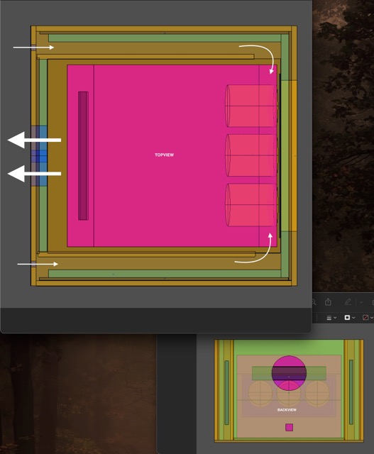

3D sketch:

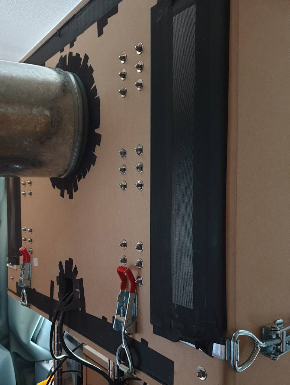

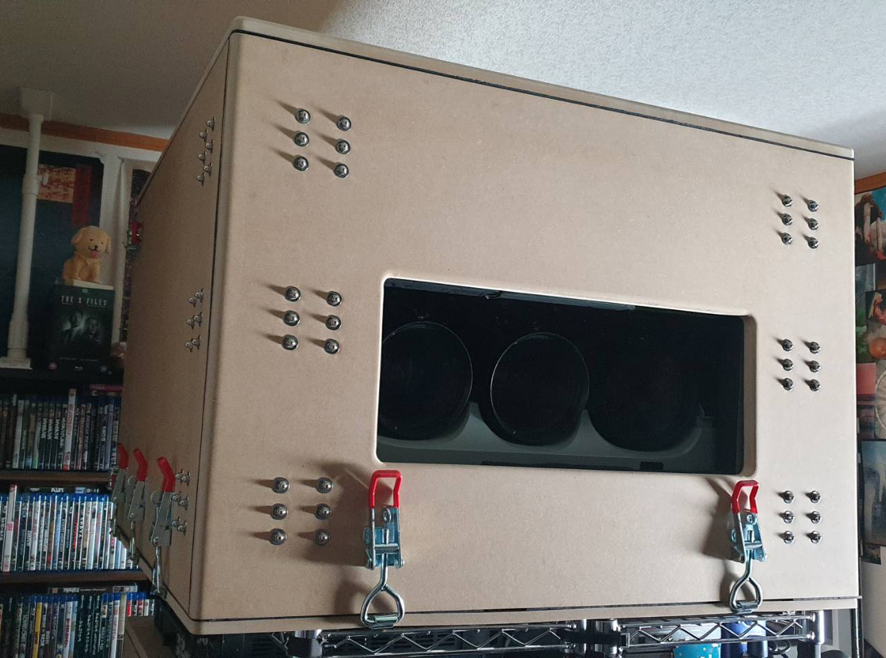

Posted: Sat Jun 15, 2024 5:49 am    Post subject:
Thanks.
I've managed to put the thing together and it works perfectly.
The only thing I'm hearing is the 200mm ductfan a few meters away, all sound from the projector itself is gone.
Not even hearing the 'click' when you turn it on/off.
My led lights make a small dip so that's how I know it turned on. Mr. Green

Posted: Sat Jun 15, 2024 5:50 pm    Post subject:
What's the back look like? How is air forced out of the box? You need some way to suck air through otherwise you'll fry the projector. You can't rely on the CRT projector's fans to do that. You can see how I did mine years ago here: http://www.curtpalme.com/Hushbox1.shtm
The key was to have that external fan separate from the room to reduce noise .

Posted: Sat Jun 15, 2024 6:55 pm    Post subject:
Don't worry. Wink
The 200mm fan is still in place.
I replace the custom duct with a hushbox.
Played a few hours of gta5 without a hitch.
 Filesize:  244.37 KB
 Viewed:  813 Time(s)
Posted: Sun Jun 16, 2024 2:01 pm    Post subject:
So there's a fan at the end of the tin duct sucking air out of the hushbox? That can even run the projector even cooler than not using a hushbox. That's what I found with my setup that I linked to above. It runs cooler because I was sucking air out from near the ceiling behind the projector and moving it to a different room. Normally the heat from an expelled projector stays up near the ceiling heating up the room from the top down and ends up recirculating back into the projector. This is all normal of course but getting the heat out of the room helps even more.
Did you take any before and after temp readings inside the projector?
You won't see issues immediately if things run hotter than normal unless it's absolutely catastrophic. Increasing the projector internal temp will just shorten the life of the projector electronic components but everything will run fine. For example, e-caps will dry out faster and you'll start to see drifting sooner down the road than if it was better cooled.

Posted: Sun Jun 16, 2024 3:24 pm    Post subject:
Yeah, there is 200mm duct-fan at the other end which is more than adequate.
Added some ducts inside to guide most air through the projector.
I should put temperature sensors in it, was planning on it, but got too excited when it was finished.
Luckily I do have 'before' temps to compare it with.
