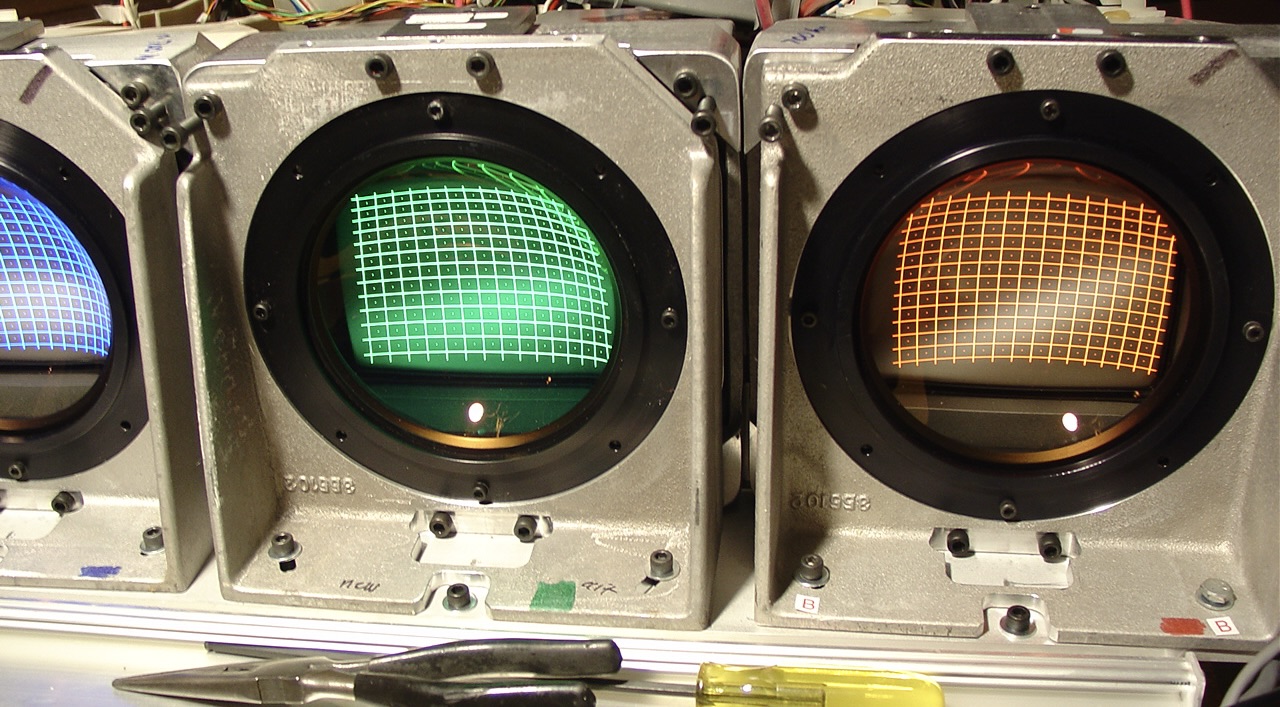

Posted: Wed Feb 28, 2024 7:05 pm    Post subject:
Hello
"Fungus" cleanup can be tricky; the glycol may have dissolved a little of the aluminum. You may have some luck draining the glycol and filling with common ammonia and let it sit a few days. Replace with fresh triethylene glycol. If unsuccessful then removing the C element lens may be necessary so the tube face can be scrubbed. One risks damaging the rubber bellows in the process. All of the Allen wrenches needed are inch denominated.
Each glycol chamber holds about 22 fluid ounces. Before loading new glycol, pressure test with distilled water if you removed the C element lens. Fill to the very top with distilled water, install the fill hole screws, and press in on the sides of the rubber bellows, looking for leaks. Water mixes easily with glycol so no need to dry out the chamber.
The blue phenomena may be a problem in the electron gun or the neckboard, which is supposed to slam the electron beam off at power down. This is known as spot kill, to protect the phosphor from scarring.
Good Luck
