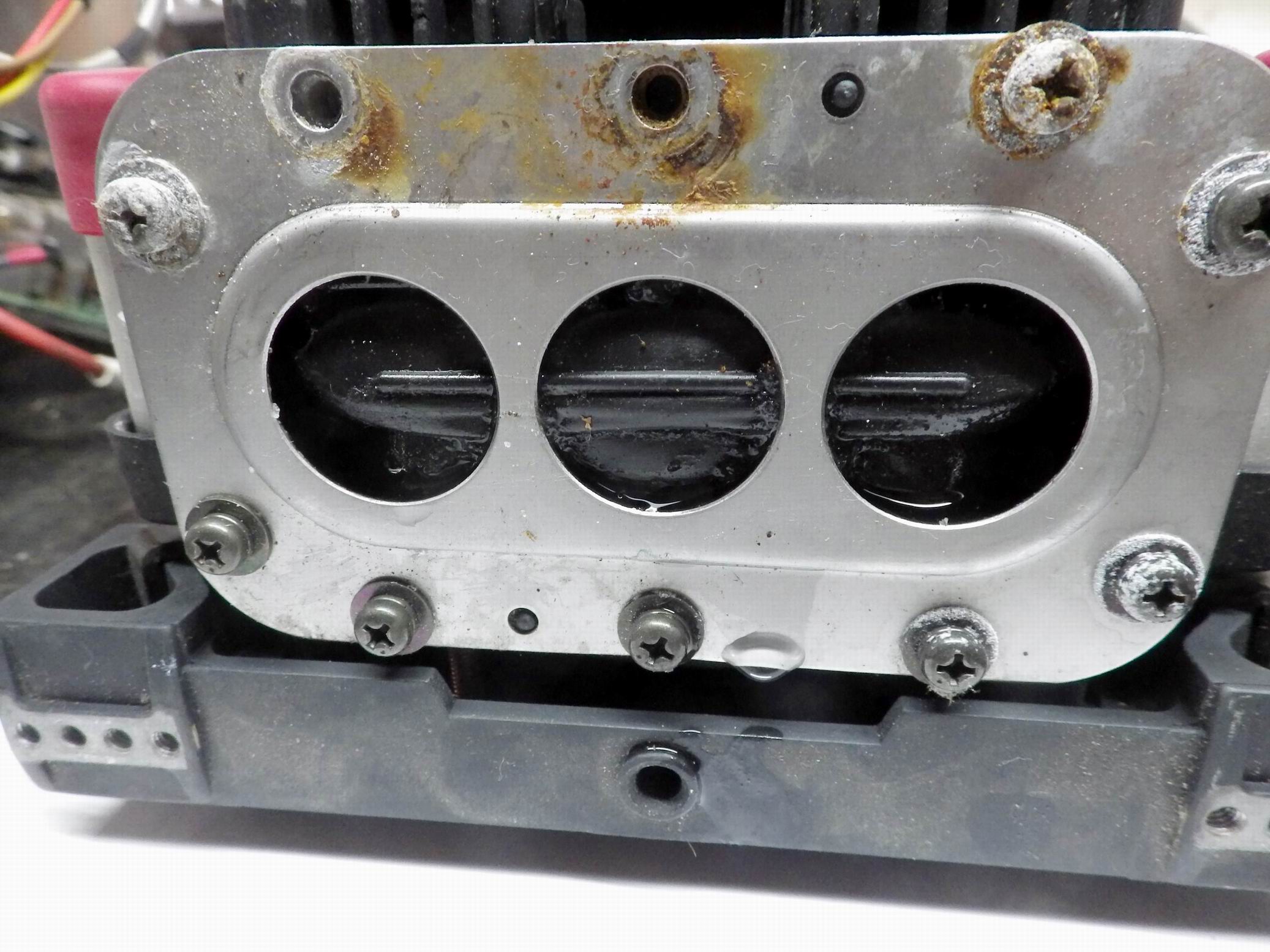

I've now found that two out of three bellows are leaking in the donor unit, all bulged like balloons, pushing out of the holes in the retaining plate with visible glycol under two of the plates.
Luckily, they don't seem to have leaked down onto the boards, as I've stripped the whole thing right down to the base, removed the boards, and there's no visible corrosion.
I was under the impression that these tubes don't need bleeding, but I can tell you at this age they sure do.
So if anyone is still using these projectors, it might be a good idea to check, probably applies to other Sony's as well.
I bled off some glycol, removed the bellows which were intact and seemed to have been leaking around the rim, cleaned and refitted them, and all seems to be OK, as far as that goes anyway.
The pic. shows one after I bled off some glycol.
I'm not sure if I'm doing this right, I've added it as an attachment, but I can't see the pic. in the preview, not sure if it's really there.
