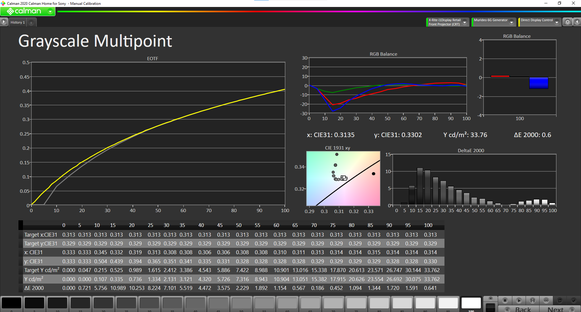

-Window Size is set to 50%, Gamma set to 2.2
-I am not a professional calibrator, I am not an expert.

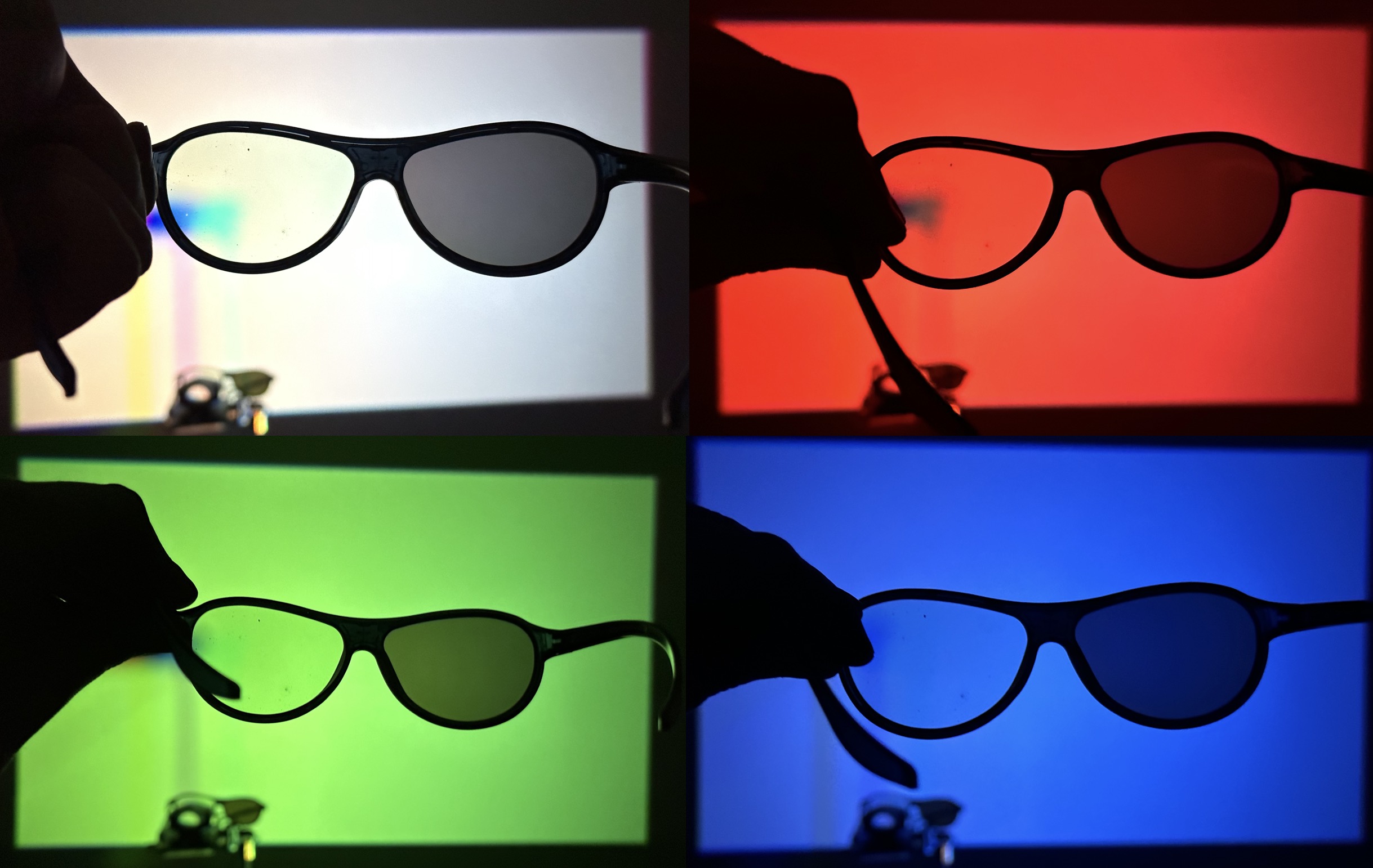

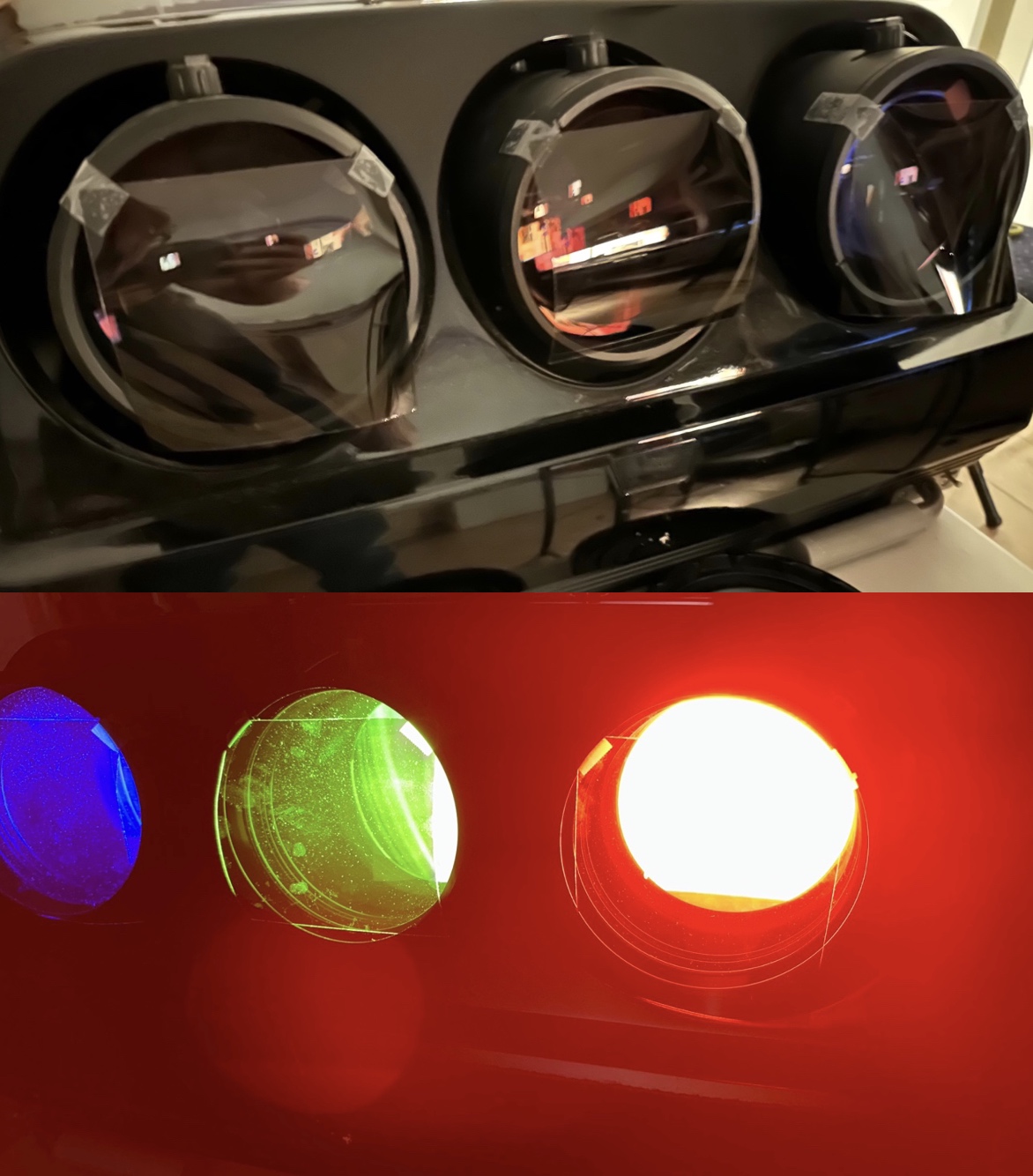

Circular polarizer filters were attached in front of the projector lenses. These are cheap $10 filters. I turned the projector on, made a quick alignment, and then tested the 3D glasses. The left lens was bright and the right lens was dim. The lack of discoloration confirmed the filters worked properly. For some unknown reason the right eye filter works with the left lens of the glasses.

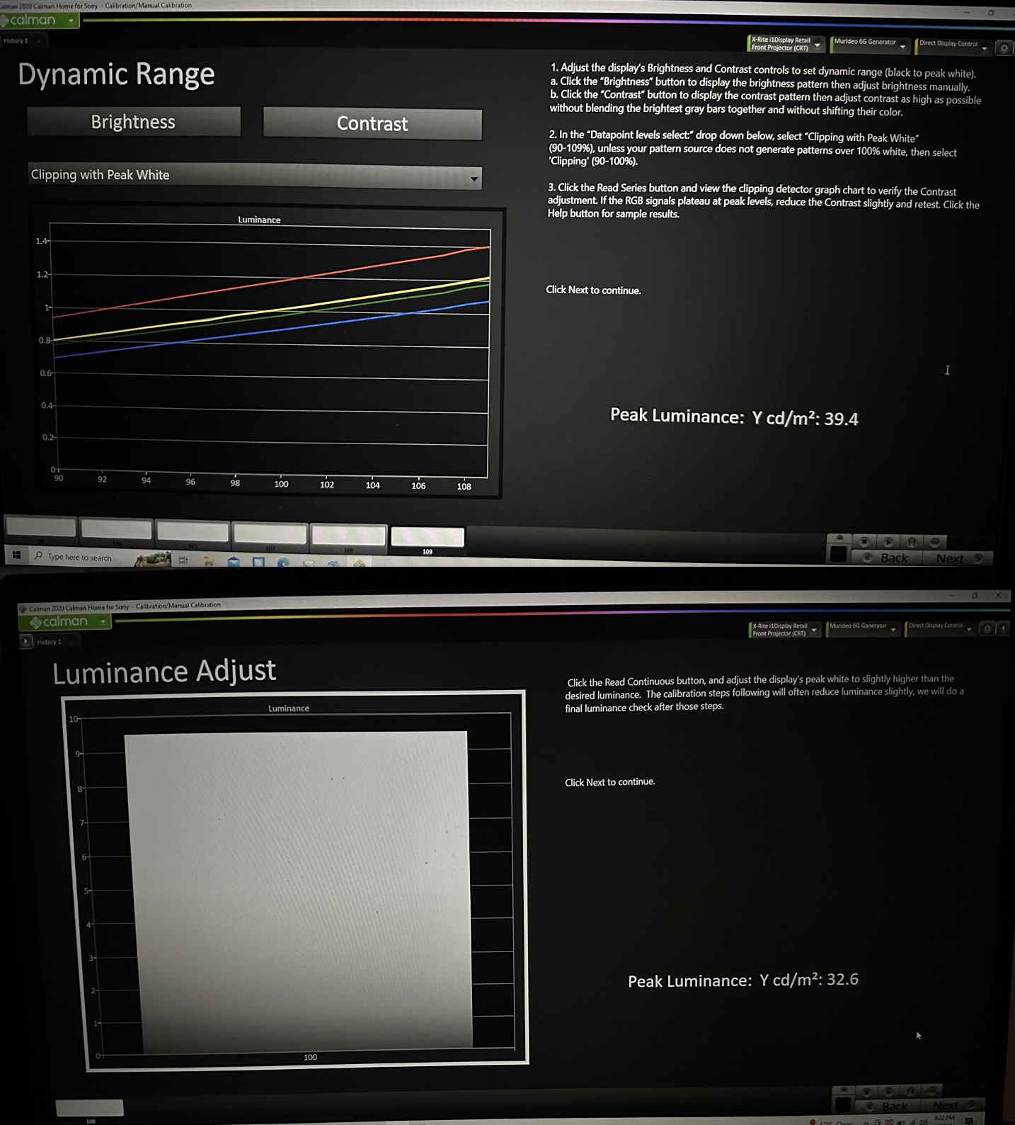

I set the i1 Display Pro on a tripod with 3D glasses and proceeded to take measurements. Upon taking re-measurements and repositioning the meter I consistently got around 33 nits (9.6 foot-lamberts). The brightness measurement appears to be representative of what I was seeing.
