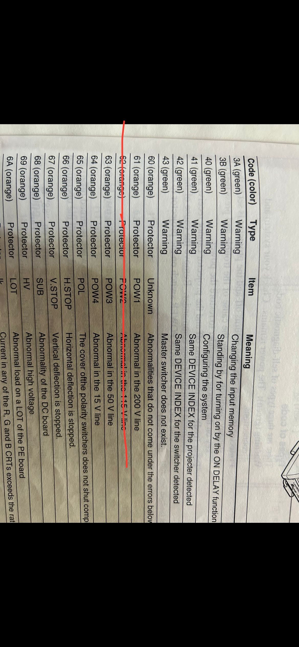

Ceiling mounted? Sure its not error 61. I don't see an error code 19 in the manual. If 61, appears to be an issue with the PS.
 Filename:  QQ图片20240113132637.jpg
 Filesize:  379.19 KB
 Downloaded:  68 Time(s)
Posted: Sat Jan 13, 2024 8:21 pm    Post subject:
Error 61 is a bad LV power supply. Usually one of the daughter boards has gone bad on it.
I have ONE LVPS board here that tested OK around 2018 or so. Can't test it now due to me not having any G90s here though. Yours for $100 incl shipping if you want it. Otherwise, Craig Rounds may have a testede working one to sell.. or he can repair yours if he's still doing it.
