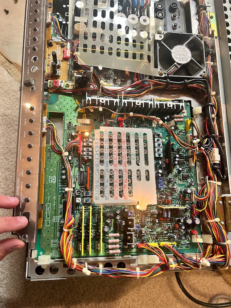

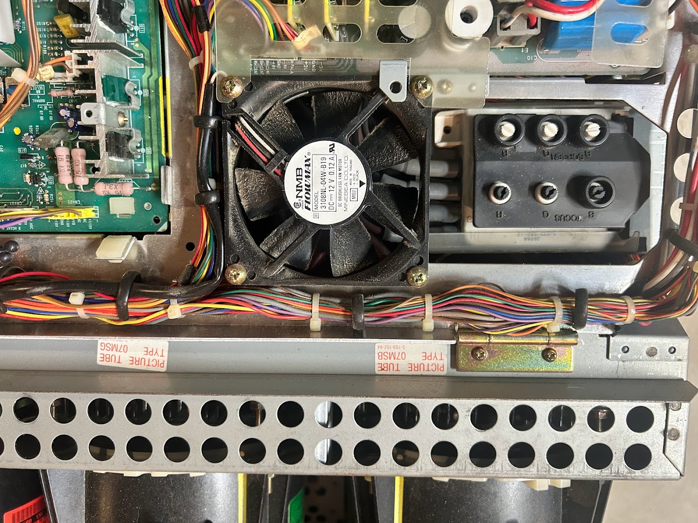

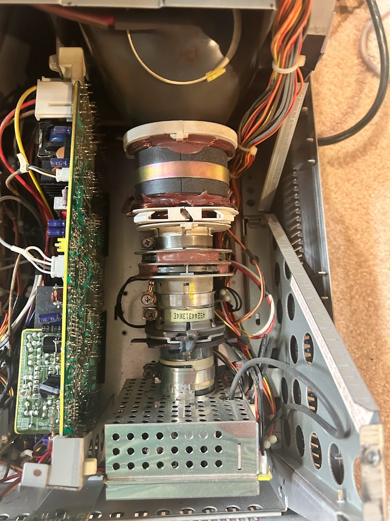

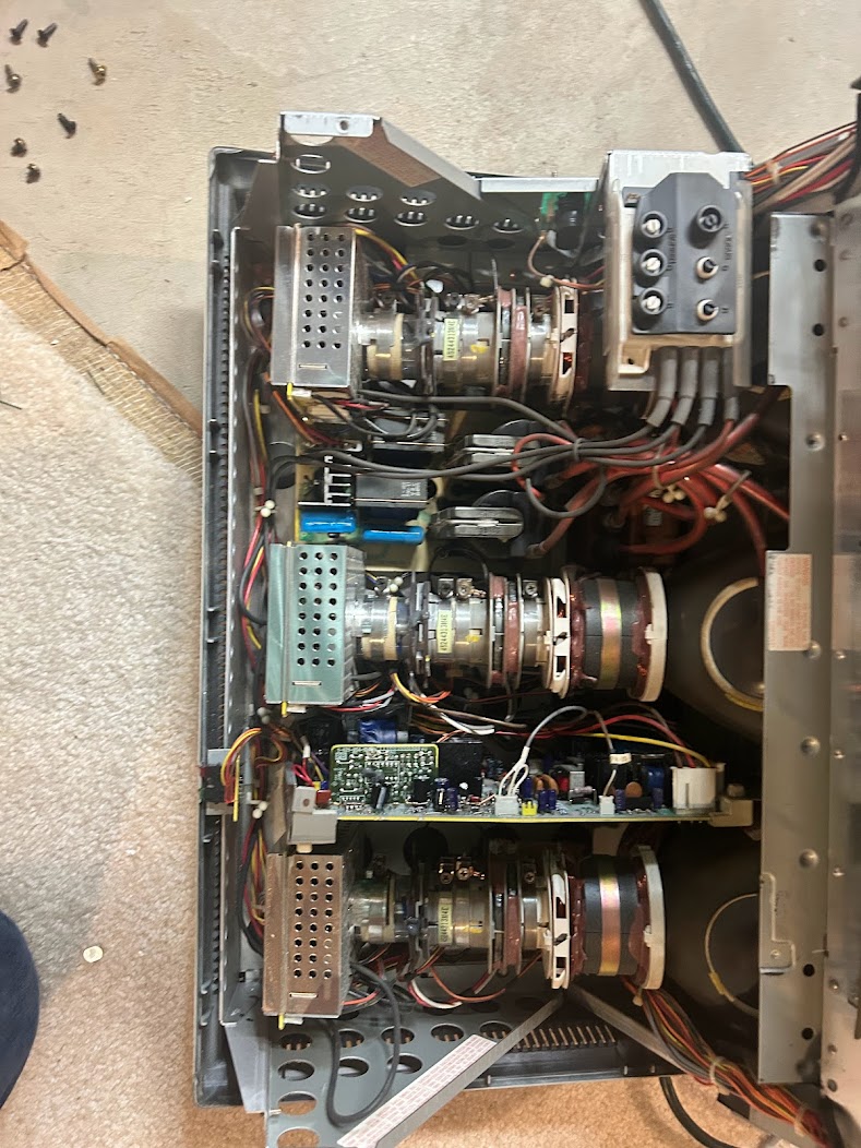

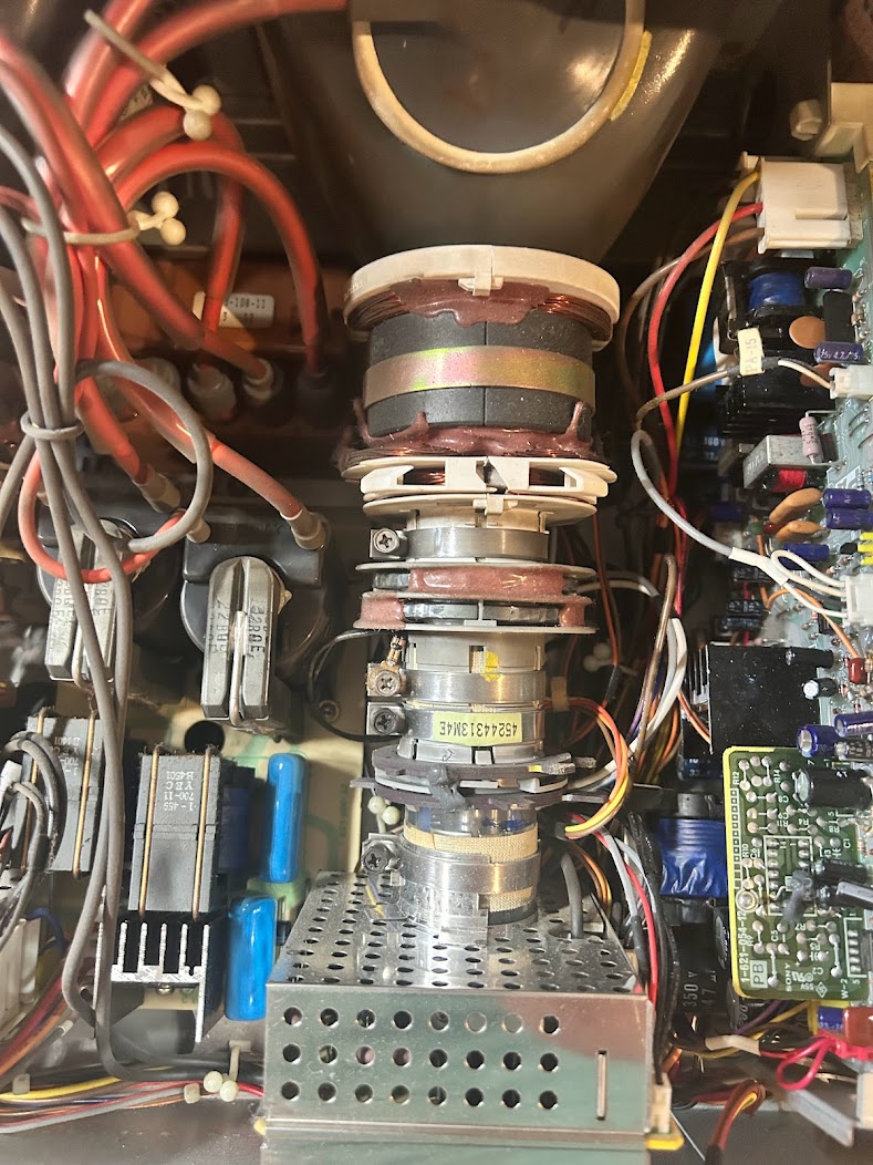

Hi all, new to the world of CRT projectors and found this forum. I picked up a free Sony projector, guy used it for years then it stopped turning on. when you turn it on it powers up for 1 second fans come on, can hear some degauzz? that whoosh sound then it goes right back to standyby mode. tried searching here to no avail. where to begin? its in nice shape. photos attached. capacitors look good, no bulging. i have plenty of pics, wont let me post them here. really wanted this for use with my laserdisc collection.

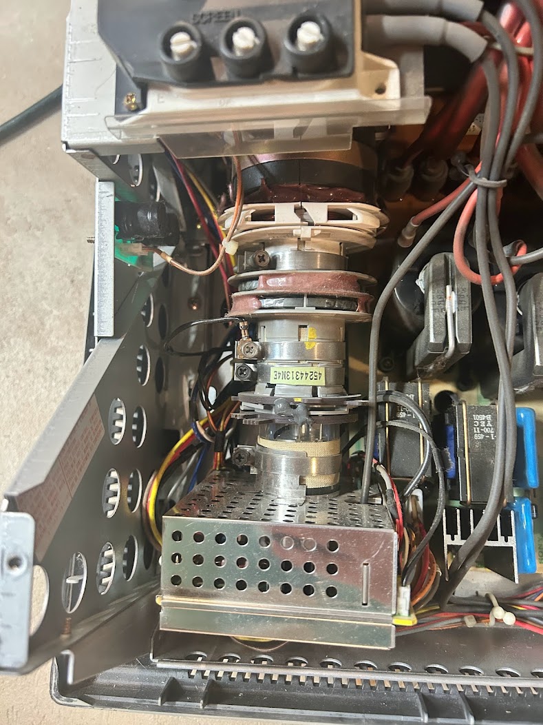

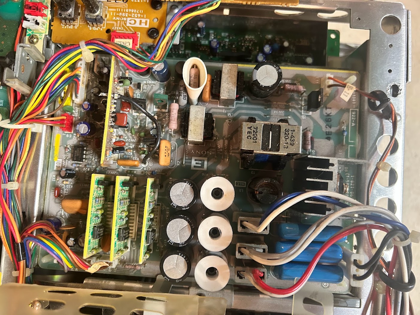

more pics

Maybe a High Voltage issue if it shuts down just as you hear the High Voltage some up. See that block with the red wires running into it in 3791 at the top of the screen? That's the high voltage section.
Turn off the lights, hit the power and see if there are any sparks flying from any of those wires to the chassis.
ALso do all three tubes glow at the back ( skinny neck end opposite the lenses)? There should be a faint orange glow there.

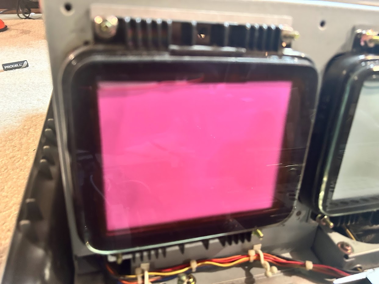

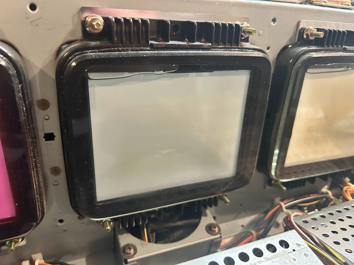

Posted: Mon Nov 27, 2023 4:05 pm    Post subject:

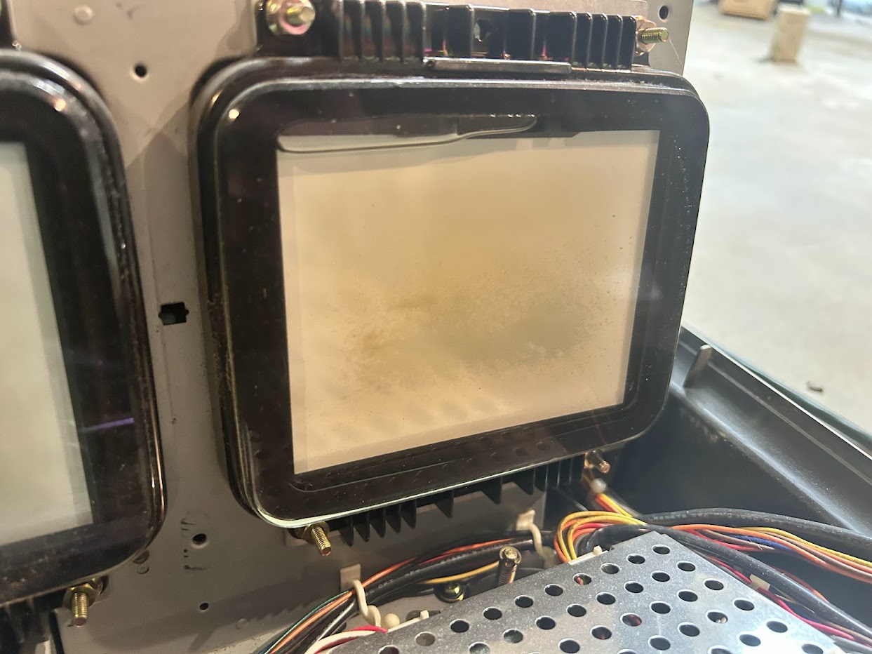

the only tube that give a glimmer of glow is the green. nothing else. the CRTs look a little rough to me after taking off the lenses to look at them

A shutdown on the 10XX series could be an imploded tube. If the HV is arcing within the tube due to loss of vacuum, then the set will sense that, and shut down. ON the older 1031/1030/1020 I had lots of problems with the power supplies dying. Or, a fault in either deflection circuit (H/V) can trigger the power supply to shut down.
