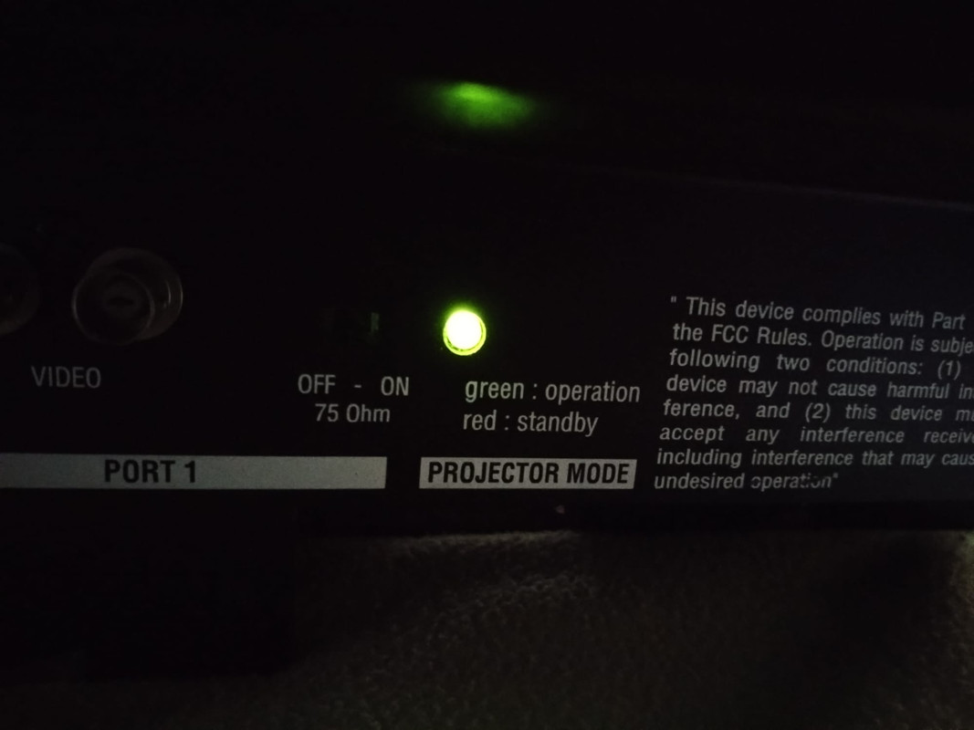

I am happy new owner of Barco 909. I bought it as a faulty unit with close to new tubes. Barco powers up, there is green indicator, fans are running. But there is no picture.

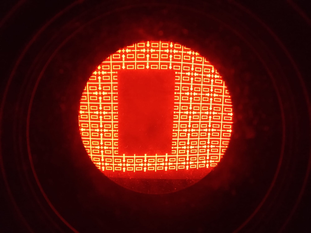

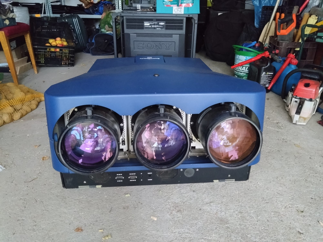

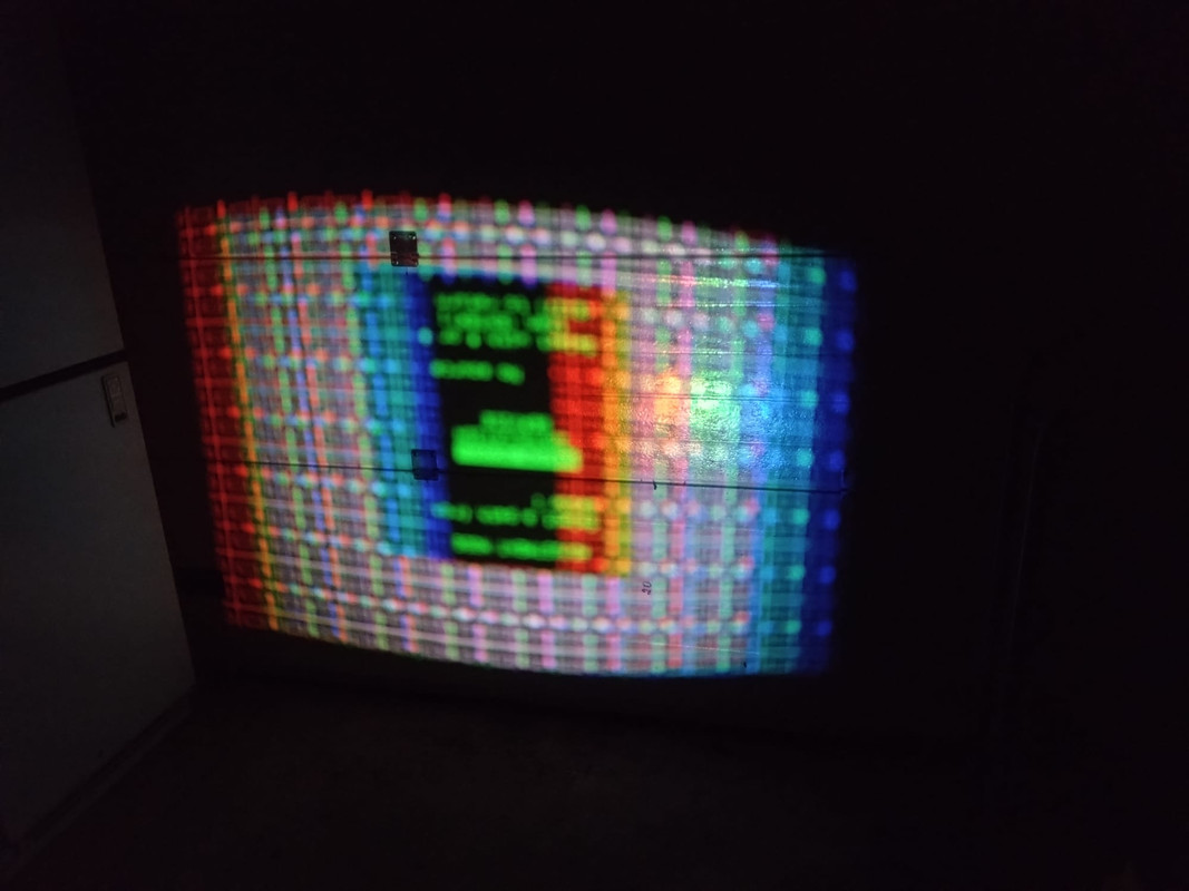

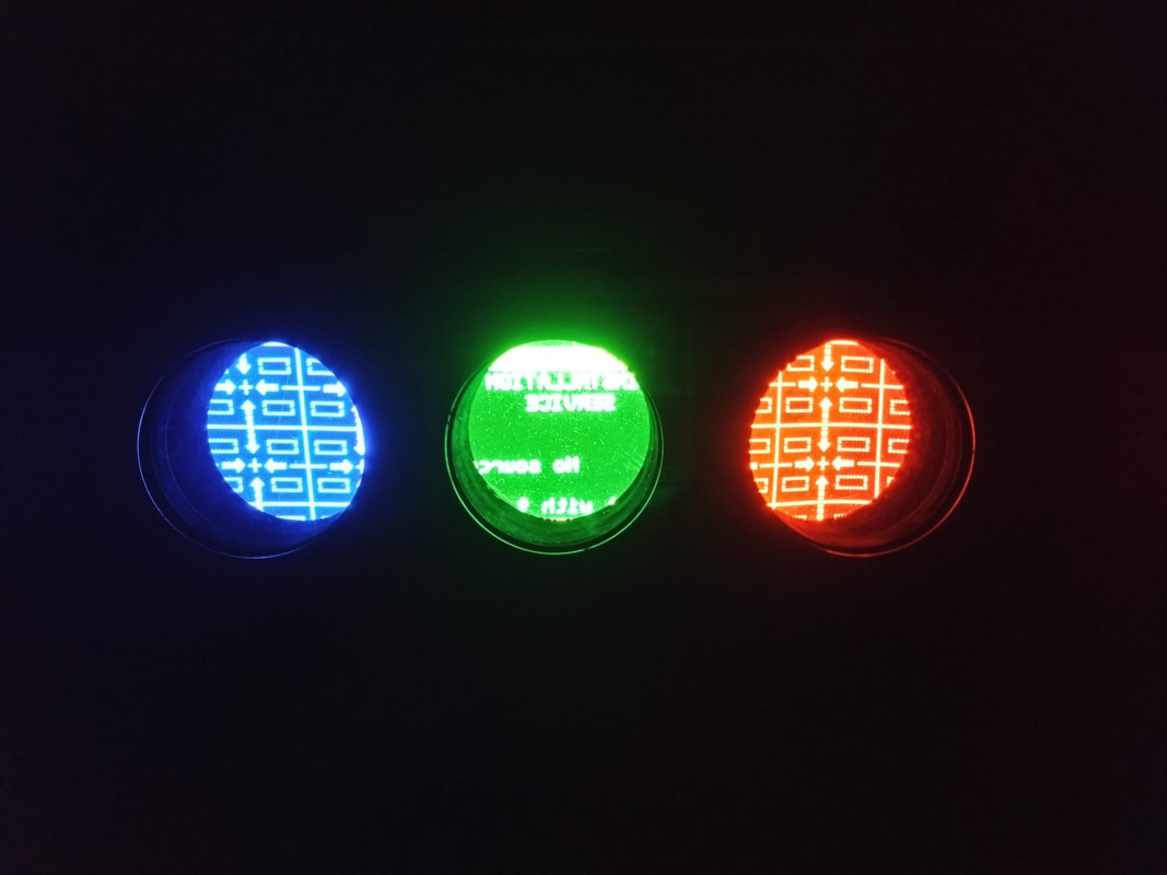

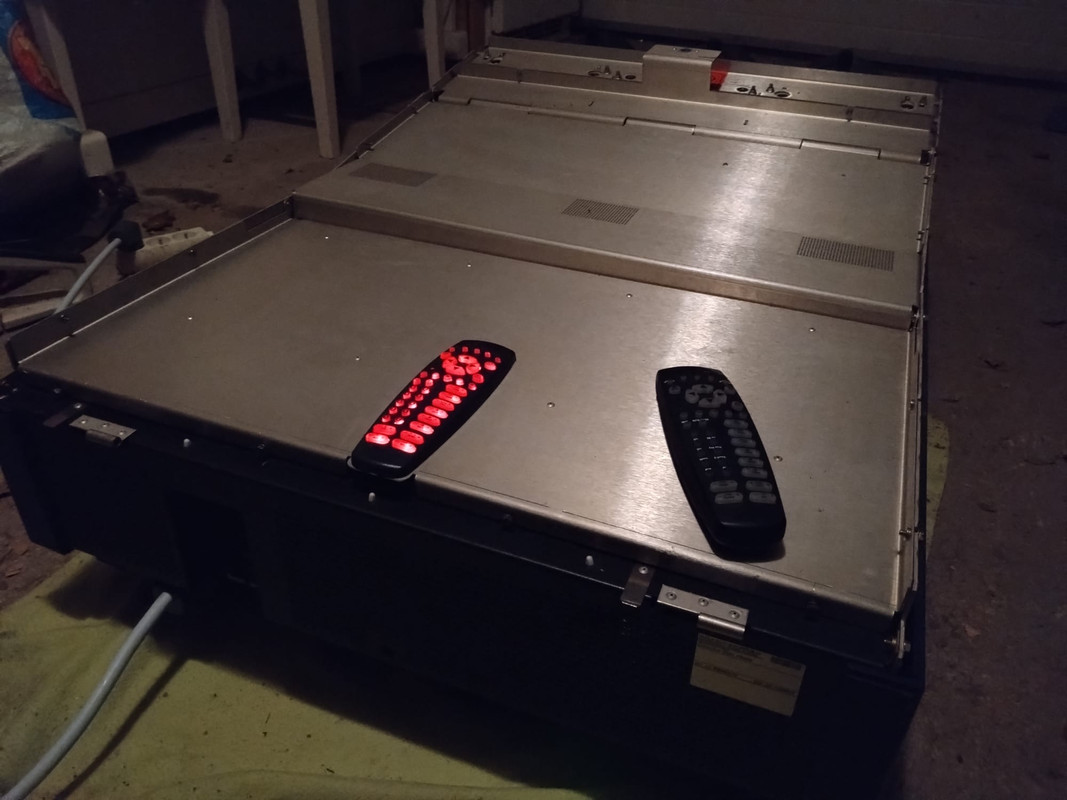

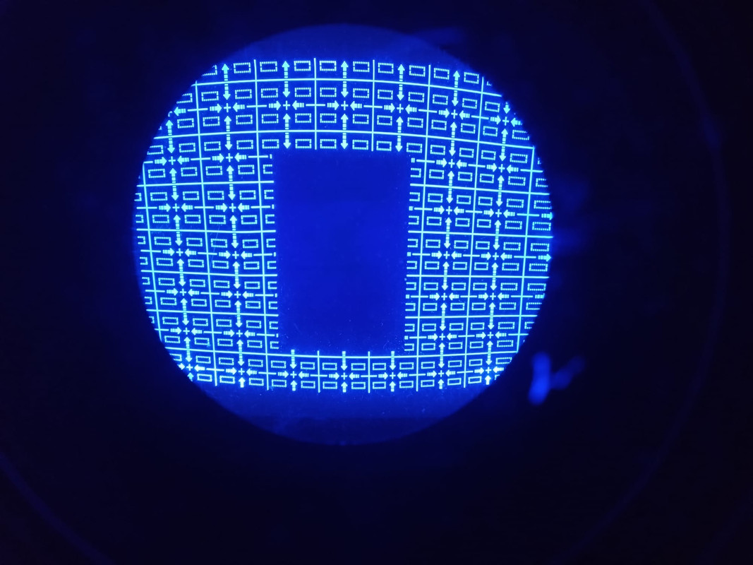

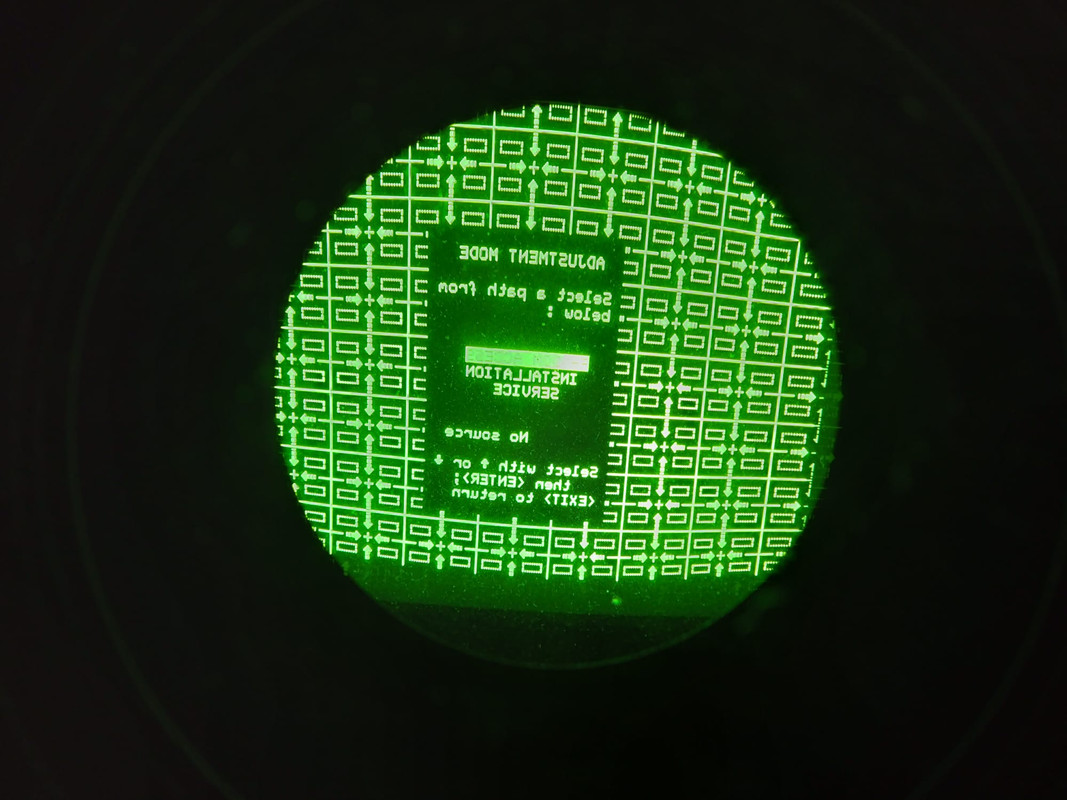

Thank you Hulio. Before I had chance to try your detailed diagnosis, there was some sudden development. I was trying with Barco for second time on my own. I don't know, what I did, but suddenly Barco started giving some picture. If I look inside the lenses, there is clear image in all three tubes (although geometry especially of red tube is all over the place). The projected image on the gate of garage is very blurred, but I suggest the reason is very short distance (cca 1,5 m) - I will try with larger distance. So maybe there won't be any fault (hopefully). Anyway I will try the diagnosis to check, if all is really allright.
Here are some images (I already found out how to upload them):

Posted: Mon Nov 13, 2023 10:18 pm    Post subject:
Looking good. Try to adjust the center focus knob on the lenses (the one closest to the tubes). If you are out of adjustment and the text is still not in focus, the projector is indeed to close.
Anyway, first thing you should do before installation, is to go in the service menu, delete all previous memory blocks and then put all setting in midposition.
