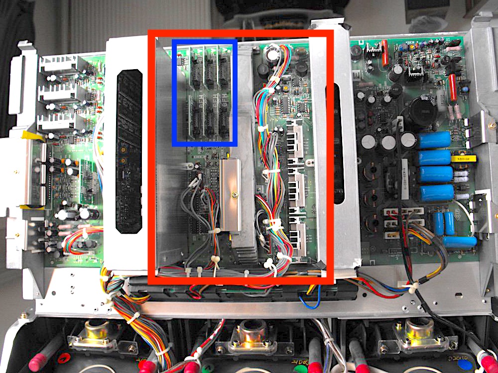

In my quest to find what part is responsible for the convergence, I read some information about the G70 from this site.
I believe the red squared area in the pic is the convergence part for the D50. Wish the D50 had the board pull-out mechanic of the g70/90…seems quite a hassle to disconnect the entire board.
Now I guess these little boards (blue squared) would be most responsible for convergence?
If so I might start with those, since it looks like you can pull those out.

Posted: Thu Oct 12, 2023 9:45 pm    Post subject:
No idea, sorry. the service manual (available on our site) may give you some clues.

Posted: Thu Dec 21, 2023 1:05 pm    Post subject:
Minor update.
I took out the 6 small boards from another D50 I have in storage (JP version).
Switched them with my running USA version and the problem seemed solved.

(!)Sadly the drifting started again, replacing the caps on the 6 little boards seems necessary.
It ran fine for a few days with the JP boards, which makes me hopeful this might cure it once and for all.
The order for new long lasting caps is in (backordered), hope to replace them by the end of january.

Posted: Thu Feb 15, 2024 1:05 pm    Post subject:
For posterity, the caps arrived 2 weeks ago.
These ones specifcally,
https://www.mouser.com/ProductDetail/KEMET/ESW226M016AC3AA?qs=F5EMLAvA7IDQPRbD1Pv4%252BQ%3D%3D
Replaced them on all 6 mini boards, they were a bit taller than the originals so I had to bend the legs a little.
The problem is completely gone. Thumbs Up
