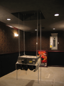

And then you need to hoist the beast up to the ceiling. This is (Clarence's animation of) my preferred method: hang chains from the strut, and attach hooks to the bottom of the projector. Raise it up one corner at a time. I used this on a Sony G-90 and an Electrohome 8500 (twice). Took it from floor to "attached to the strut" in less than 30 minutes, by myself.

Posted: Thu Sep 28, 2023 12:50 pm    Post subject:
Yep. Used that method myself. I like it because (if done correctly) it's perfectly safe, no chance of dropping it, and you can do it alone.
