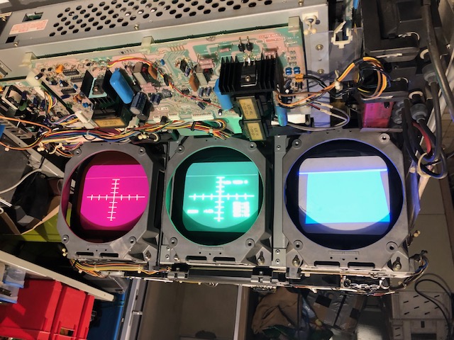

Hello ,
I just recovered this projector that I had given to a friend , this projector remained without working for more than ten years .
After some code 04 it ended up working .
With a concern on the blue tube:
No video signal and no name display menus.
Problem with the VPH 05 video amp?
My friend wanted to throw it away and I put it back in service , I know that this 1251 is not the best of projectors but I might as well run it again , it will certainly please another nostalgic .

Posted: Sat Aug 26, 2023 8:14 pm    Post subject:
Unless it's bad solder connections on the blue video board, yes, I'd suspect the VPH chip. I'm assuming the test patterns don't come up on the blue tube either?

Posted: Sat Aug 26, 2023 8:23 pm    Post subject:
Hello Curt,
Always available to help
No menu or pattern or videos.
On my side I checked and cleaned all the connectors from the input board to the socket of the blue tube .
I found a vph to buy for 36 € I will try ca.
It was the problem on the B800/B801 these amps vph. I remember vph 06

Posted: Mon Sep 04, 2023 2:21 pm    Post subject:
Hello ,
VPH05 replaced but the problem of no video (no menus or pattern either) persists .
The best is to find a CA Board (B)?
Have a good day,
Pierre-Marie.
Posted: Mon Sep 04, 2023 2:28 pm    Post subject:
Yes, I'd say so. You might also have a problem on the RGB input board, that drives the CA(B) board. IN fact, pull out the RGB input board and reseat it to see if that works.

Posted: Mon Sep 04, 2023 2:40 pm    Post subject:
Hello Curt,
Can you tell me the name of this RGB card? I’m not familiar with abbreviations Sony .. BA and BB ?
I took out the input cards BA and BB , I have no video signal of course , but the patterns and menus still appear on the green and red tube.
Thank you.
Pierre-Marie.
Posted: Tue Sep 05, 2023 12:21 am    Post subject:
OK, yes, the input cards, with the RGBHV connectors on it. Sounds like the CA(B) is bad.
