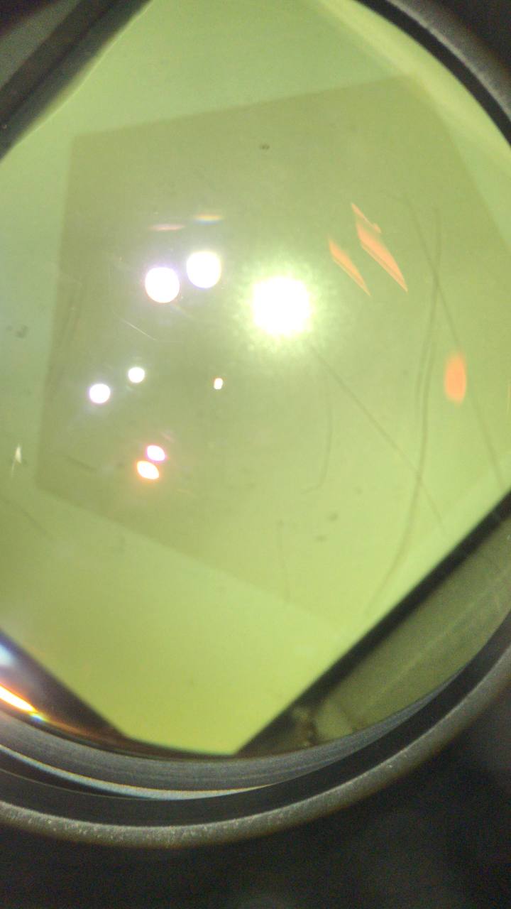

I've just come into 3 Marquee 9500 LC Ultra projectors, from a lot of about 12. Most of the lot have got the strangest burn pattern on the green and blue tubes - but the red tubes are pristine, and were actually switched off on all of the ones I was able to test from the lot.
What do y'all make of this?

Projectors were used in a simulator or similar.

Interesting! Do you have any more information (or a place I can find it) on how these would have been set up, what they would have been projecting, and why the red tube was never used?
Posted: Sun Nov 27, 2022 2:27 am    Post subject:
There's any number of a million types of setups possible. This was likely used in a sim where multiple projectors were set up to each project only a segment of the displayed area. What was done depends entirely on what the company was up to, what sort of whacky curved screen setup they had (they're all different so impossible to be specific - where ever you saw these from may have more details). Marquees were very flexible about this so you'd often see them used in sims.
Very common back in to the day to have people come on the forum here wondering about odd burn-in. Search the forum for lots of previous discussions or read on the main site for lots of articles and tips. Start here: http://www.curtpalme.com/TechTips.shtm
That's the best way to learn as nobody's been posting here for years really as all CRT projector discussion died 5+ years ago.
Red likely not used because these were likely used for flight sims. Very little to no red in sky/ground. It's mostly blue and green.
As as always been the case with used CRT projectors, tube condition is everything. Uneven burn makes projectors useless. Nobody wants projectors used in sims due to the oddball burn-in.

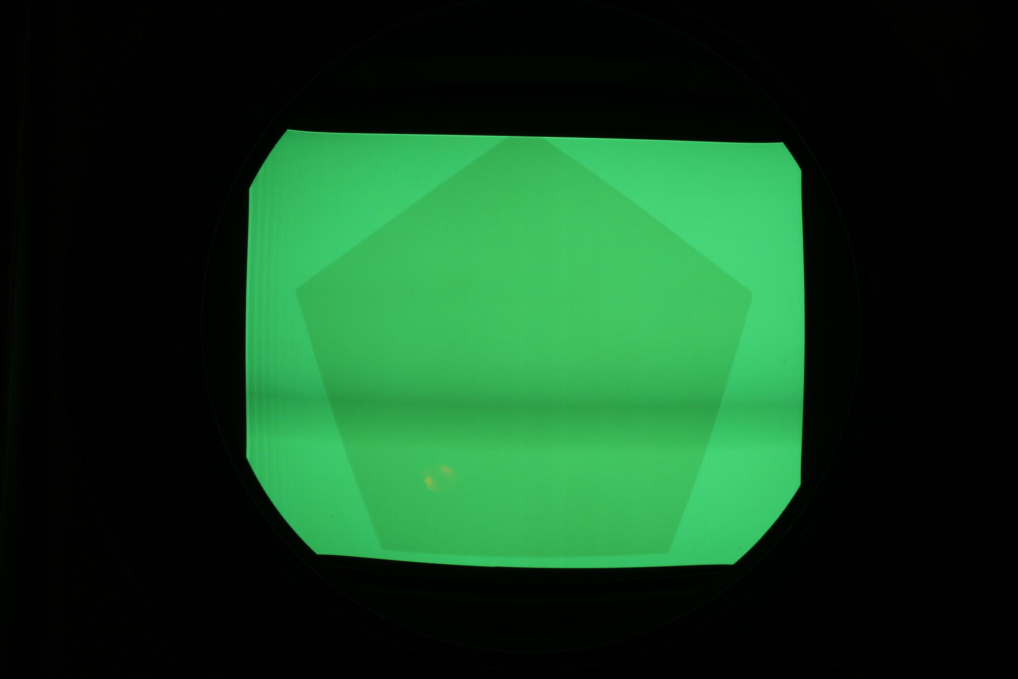

Alright - both I and my husband spent a good 4 hours together trying to line up a burn mask in various ways, and we just couldn't make it happen. And then I came to an important realization: I'm a programmer! That's my job! Not just any kind of programmer, either, but a graphics programmer!
So... I whipped up a quick program to render a pentagon on the screen, and let me do things like drag around its vertices, swap the foreground/background color, etc. I got that lined up on the screen in 5 minutes, and had my husband check it as well, and it looks to be well-aligned. Defocused the tube a bit, cranked the contrast up to about 75, and now I'm letting it burn. I'm checking at one-hour intervals, and will try and report back whenever anything significant happens!
Program can be found here, if anyone wants it. I wrote it for Linux, in C. https://pastebin.com/5nArZg9e
Edited to update:
I've just let the green tube burn for rougly 4 hours with the mask, and I am beginning to see a very faint outline of the new burn pattern around the edge of the tube face. I plan to run it for at least 8 hours tomorrow, up to 12 hours if I have the time, and check on it every 2 hours or so. The next update I provide will likely be when the process is complete for the green tube, or if something goes wrong or something otherwise notable happens.

Just a small update since it's been so long... I've been burning it in for about 28 hours so far. I would say it's about half done. I don't have pictures just yet, but I'll try and take some after this next cycle (I'm checking it in 2 hour increments, and there's about an hour and a half left of this increment.)
I made some tweaks to my little program - mainly to add support for saving the shape to a file and loading it back up later, in case I need to restart the computer. However, so far the computer running the program has been running 24/7 since I started the burn, and all is well so far. I'll probably post the complete code of the final version of the program once this is all done, in case anyone else may come across this thread and find it useful.

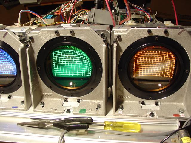

Raster shift can be done several ways. First, go to CONV, 5, pw 0901, 1 and hit 0 to null out any green shift coming thru convergence, and see if that is centered. You can then choose to center the raster using green converge; or flare magnet adjustment, or focus yoke positioning on the tube neck.
Remember to pivot the red and blue tubes mechanically after centering by any other adjusting.
Email me if you need the Owner's Manual ehometech8022@yahoo.com
Also, if those are clear green c element lenses I would swap in the tinted lenses. I should have a few here.
Tim at E-Tech

As for progress on the burn... We've been burning for 70 hours so far of total tube on time, and the shape of the pentagon is now barely visible when the set is off. I'm monitoring it hour-by-hour tonight, but I think it shouldn't take too much longer.
The picture is still nice and bright by my standards when thrown onto a wall through the lens, so while this tube is definitely starting to look more like a 6 or a 5 on the chart on CurtPalme.com, I think by my standards it will be perfectly watchable - and I'm not exactly a heavy user.
The article I looked at on CurtPalme.com for balancing tube wear states "As a final step, a G2/white balance calibration was performed to calibrate out the new (slightly subdued) tube output. It seemed to come out right where it should be."
