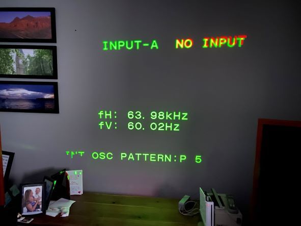

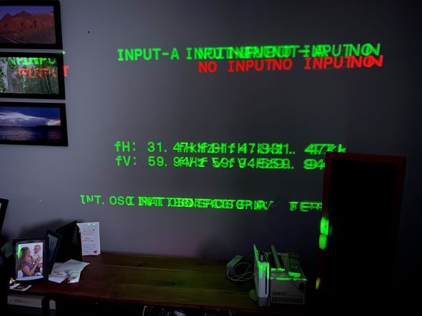

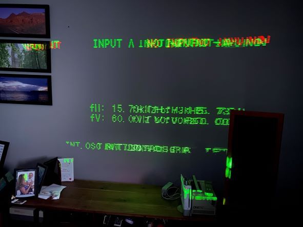

My challenge is, when I set the internal oscillator to certain scan rates, the image is garbled (distorted?). The image and menu appear correctly when the internal oscillator is set to horizontal scan rates of 24.83 kHz, 48.36 kHz, 63.98 kHz, 75.00 kHz, 93.75 kHz, and 106.25 kHz. However, when it's set to 15.73 kHz or 31.47 kHz the image is garbled, and the image is completely unviewable at 126.84 kHz and 145.00 kHz. I'm testing this on input A and input B, with or without a source connected. I've fed the projector a 15kHz image via input A (component) and can confirm that this same artifacting or garbling occurs on an input signal as well. Otherwise, I haven't noticed anything unusual about the projector's behavior.

15kHz, also garbled
 Filesize:  29.26 KB
 Viewed:  1483 Time(s)
31kHz, garbled
 Filesize:  29.8 KB
63.98Khz, looks good
 Filesize:  25.61 KB

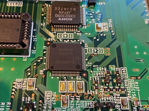

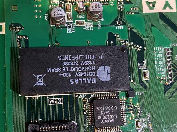

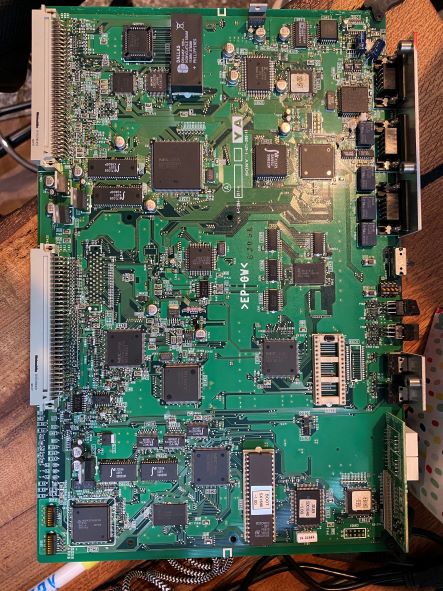

I was able to (hopefully) verify that my YA board seems good. It has an IC421 chip from one of the 'good lots' (836A01E) and the Dallas chip was replaced. Seems like the Dallas chip was from 2011. Does anyone know if these newer ones still fail? I don't think that's the problem based on my symptoms.
Dallas

IC421
 Filesize:  80.78 KB
 Viewed:  1436 Time(s)
YA Board
 Filesize:  93.17 KB
HaydnG90
Joined: 22 May 2006
Posts: 1356
Posted: Sun Nov 20, 2022 1:34 pm    Post subject:
You should definitely replace the Dallas chip just for insurance sake. Who knows when it was installed. And there have been known cases of fake Dallas chips being produced, so provenance is unclear. If that fails with the tubes on you will spot burn all 3. And lets face it, at this point all the value is in the tubes so best protect the investment.
