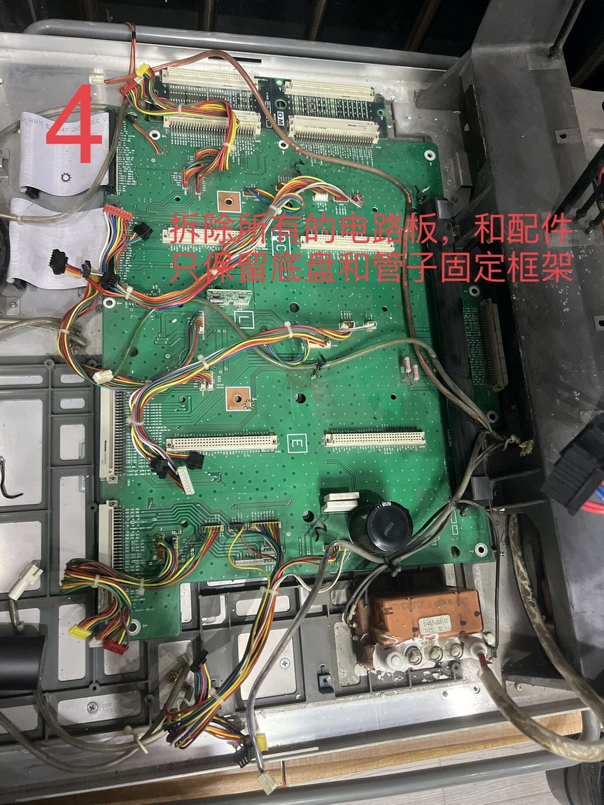

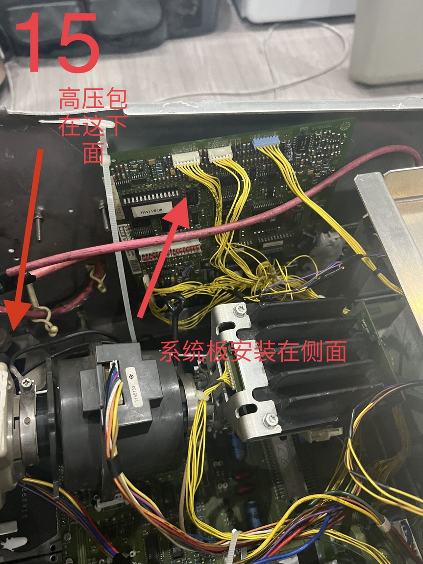

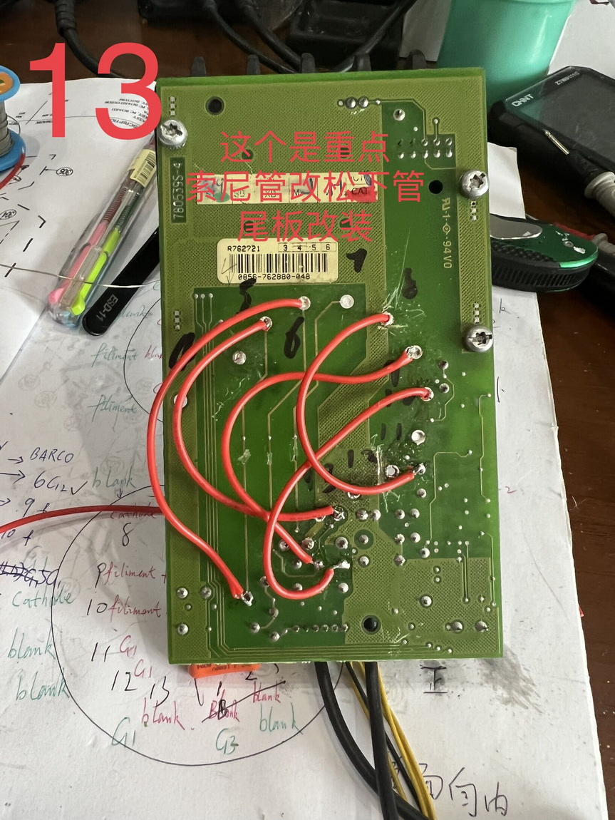

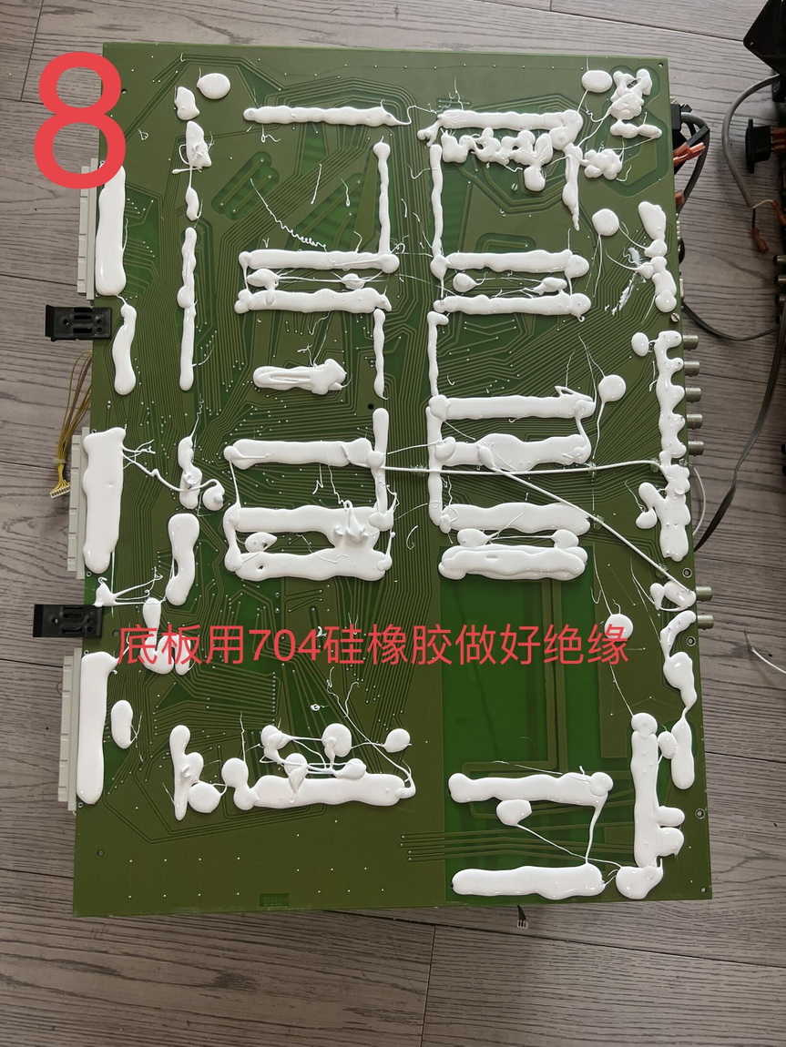

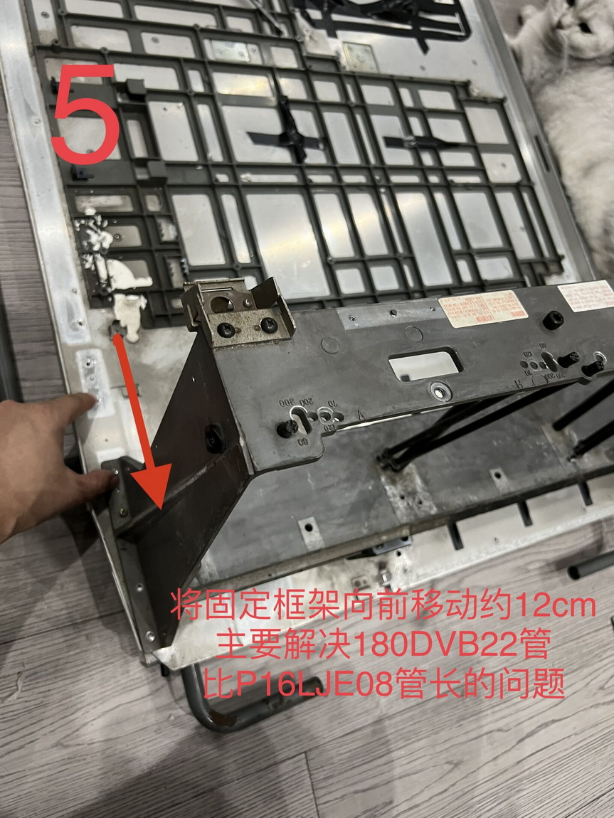

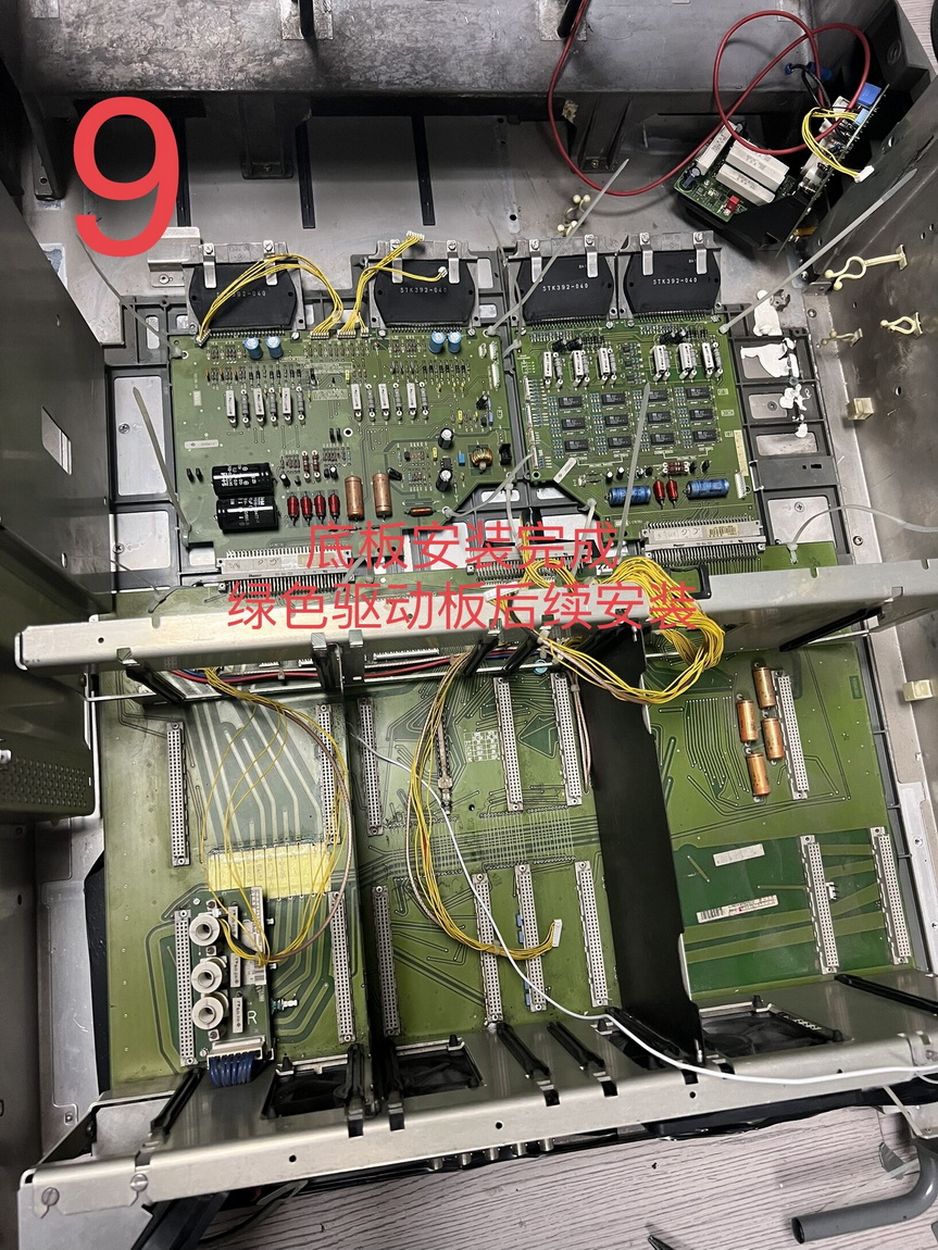

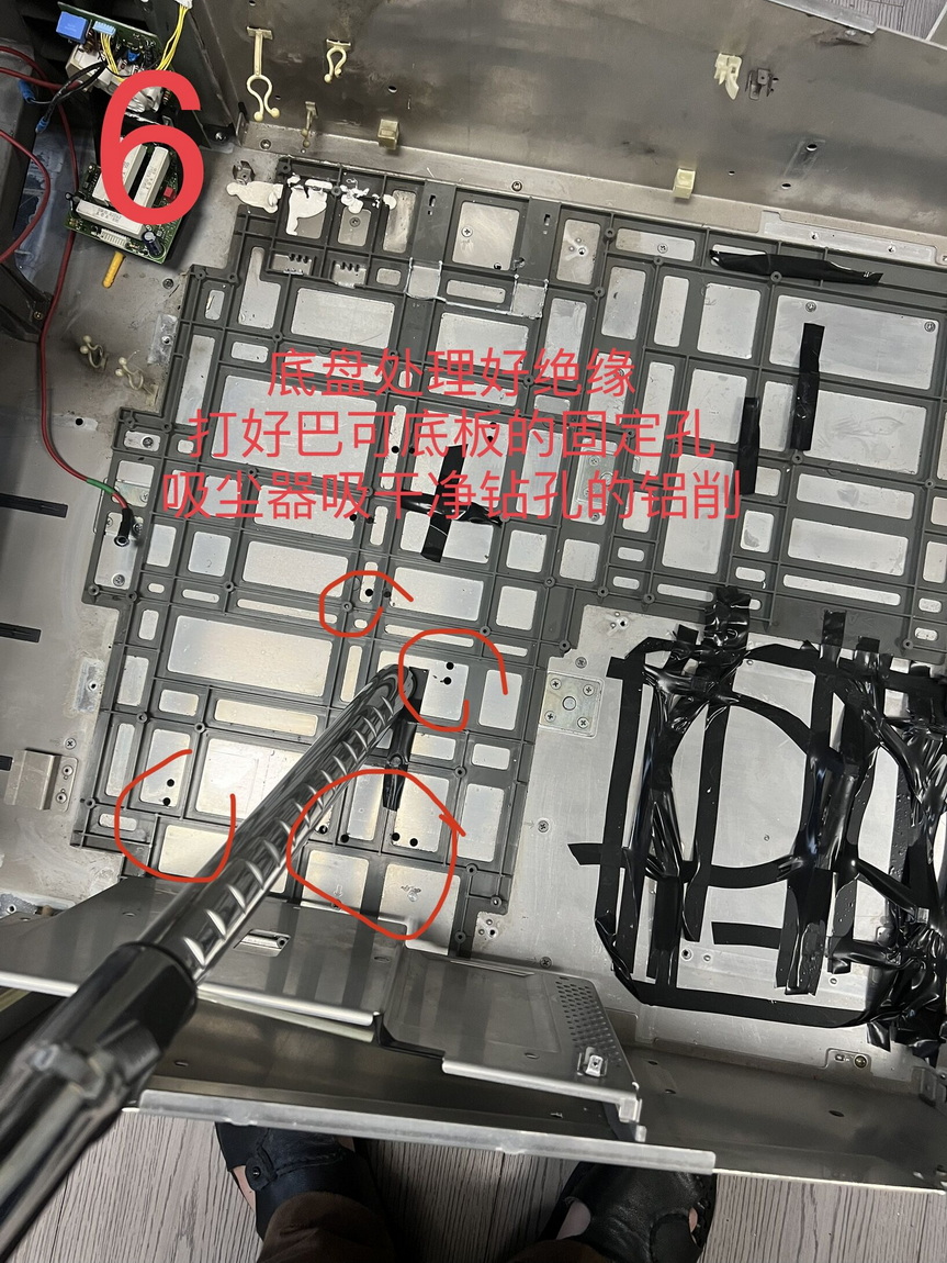

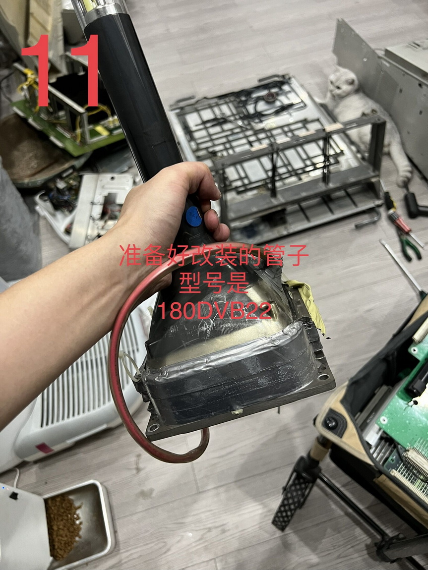

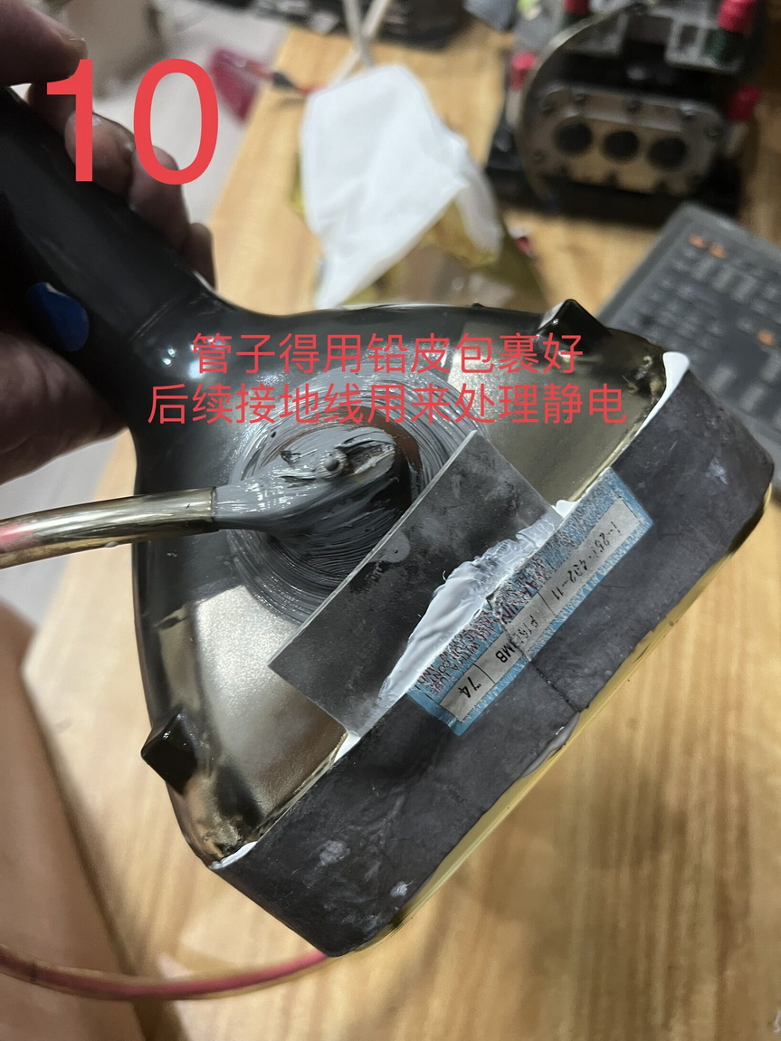

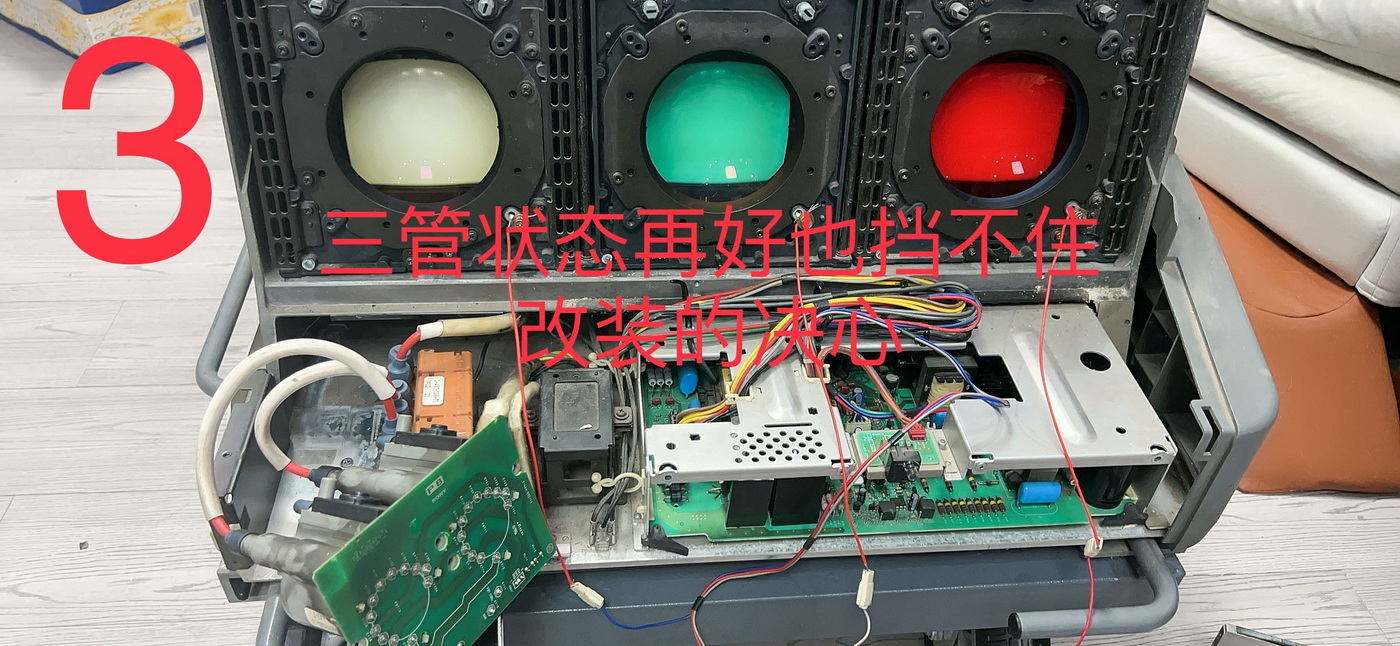

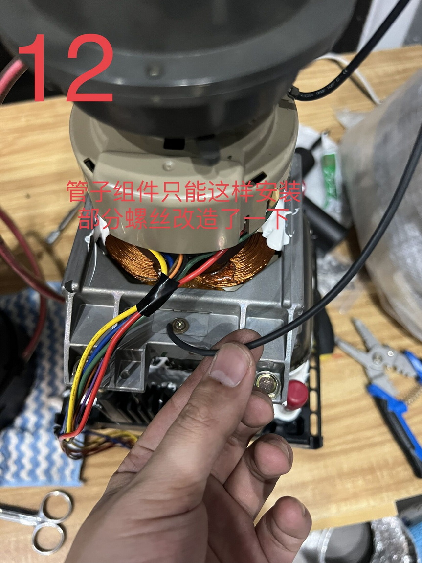

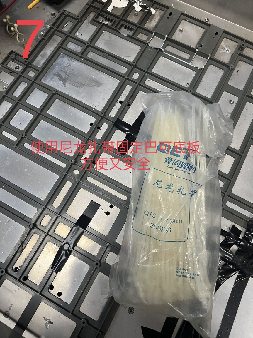

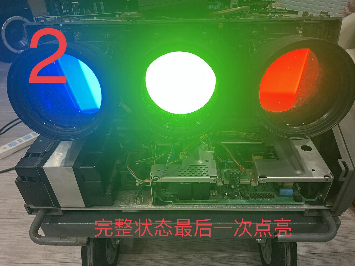

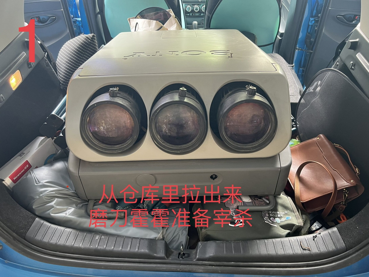

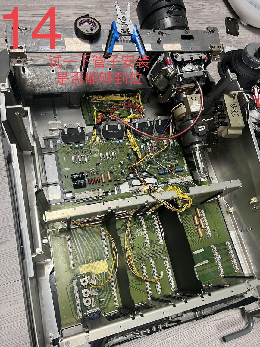

Posted: Sat Sep 17, 2022 3:35 am    Post subject: 808S+G70=G708S?
Wonderful MOD
 Filesize:  497.27 KB

Very cool! So Barco 808s guts inside a Sony G70 chassis? That seems crazy and pointless! I like it! Wink
