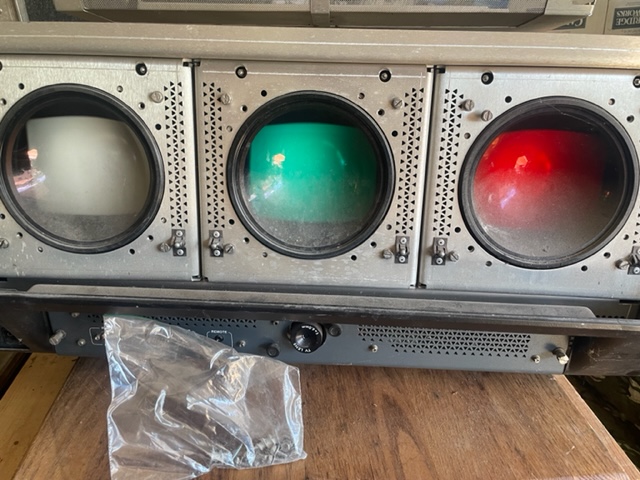

I bought the items Kal said too. I think the c elements and the HD-10 lenses are in OK shape but after cleaning I noticed some spots that look like some sort of coating is missing. Is their a antiglare coating on the c-elements and first lense on the HD-10s?
See pic of before. And I have wear on green 4:3ish and OK size usage. A little text burn of the input selection unfortunately might make this unusable. Blue has a little text burn too but I can barely see it. This does not have LUG tubes. Are new tubes still available for this and how much are they?

Posted: Thu Sep 01, 2022 11:11 pm    Post subject:
No idea if those lenses / c-elements have an anti-reflective coating but I doubt it would be removed from simple cleaning? Some talk about this from searching this website that you may want to research:
