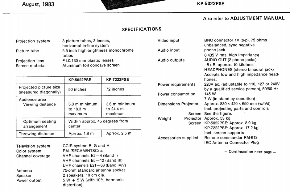

Ah, I remember. The KP-7222 model has a TV tuner and composite input through a BNC connector, the 7220 only has a TV tuner.
You can find the user manual at Curt his webserver:
http://www.curtpalme.com/docs/Sony_KP5020.pdf
And you can find the KP-7220 service manual here:
https://freeservicemanuals.info/en/servicemanuals/viewmanual/Sony/KP5020PSE/KP7220PSE/#google_vignette
Click KP-5020PSE next to "Type a" to get to the download.
(5020 is the smaller brother of 7220, smaller screen.)
