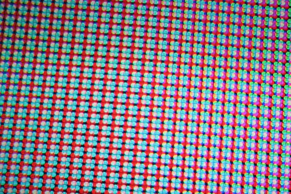

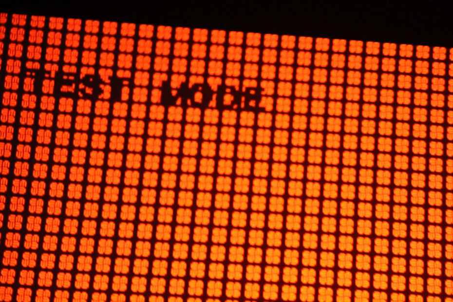

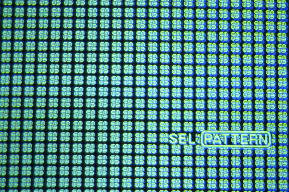

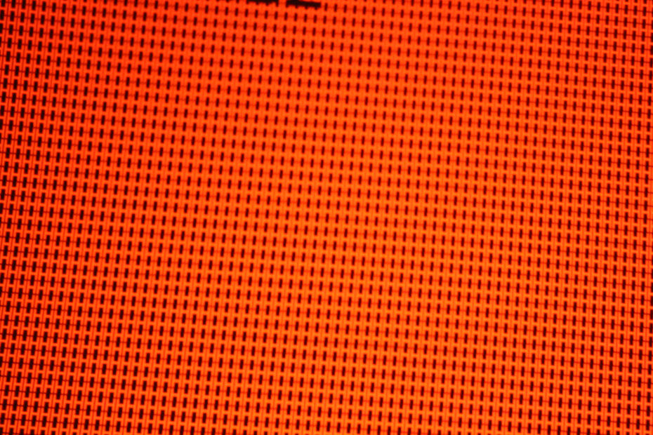

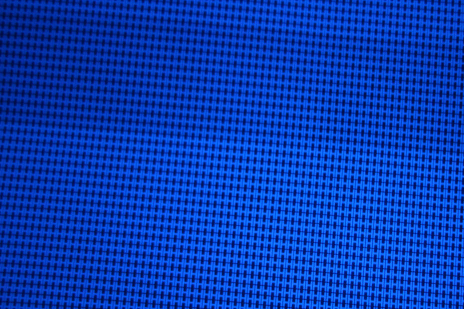

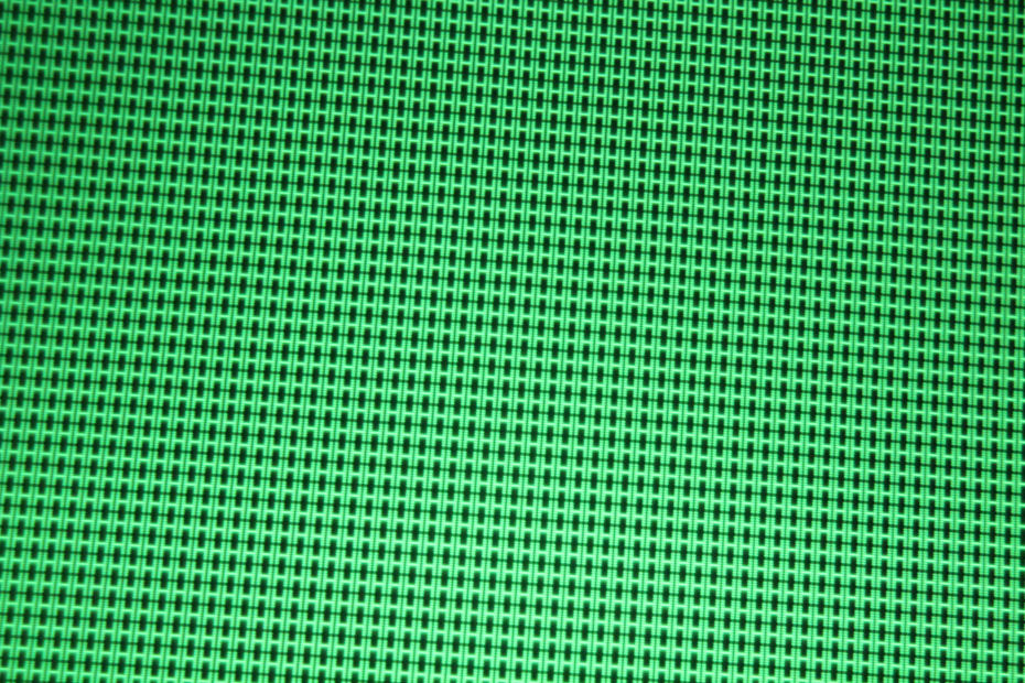

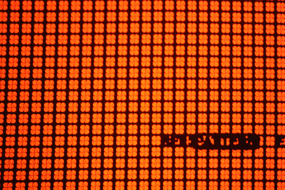

The issue so far has been trying to get it to where it can be focused with the lenses to any reasonable degree. The H or ME patterns were a blurry mess without dropping contrast to minimum until I tried pulling and reinserting boards. The middle of the red is similar to how it was for all tubes with contrast up when I made the initial post.
I've attached some photos.

My experience the corners will always be a little less focused (electronically) even with perfect lens flap and lens alignment especially if you push the raster close to the tube edge.
Are all your zones "null" if memory serves me all set to 128. I ask because your top red EM image appears sharper in the corner than towards the middle of the raster. should be the opposite.

Here's one way to tell:
If you move the rear focus adjustment (closest to the CRTs) on the lens, rocking it back and forth, and the focus can be adjusted to be good all over the screen, just not all areas at the same time, then you have a mechanical/flapping issue. If no matter what you do with the lens focusing, you can't get a part of the test pattern focused, then it's an electronic problem.
What I'd do is set all of the focus and astig settings to 128/128 to start with. If one setting is a mile off, such as astig being say 205/15, then that likely isn't the correct setting, and that will affect other zones as well.
I also usually put on sunglasses and look right into the lens while the contrast is at 100%, and then set astig and focusing right on the tube face rather than on the screen. Then you'll know the tube focusing is good, and you can then do lens flapping.
Not sure if the G70 has it, but the G90 has a 'secret' service menu that gets into additional astig adjustments.
INstead of doing enter, enter, up arrow, down arrow, enter, to get into the convergence menu, do enter enter, left arrow, right arrow, enter.
That will unlock the 6 pole astig menu. If someone has royally screwed with those settings (put them all back to 128/128), then you'll never get focusing and astig right.

Set all adjustments to 128. Start with adjusting the astig to get round dots. Failure to do astig properly so that the dots don't move, and go from round out of focus dots, to in focus, and then out of focus again as you run past the best focusing point is crucial. Failure to get the astig right means you'll never get the focusing at its peak performance.
