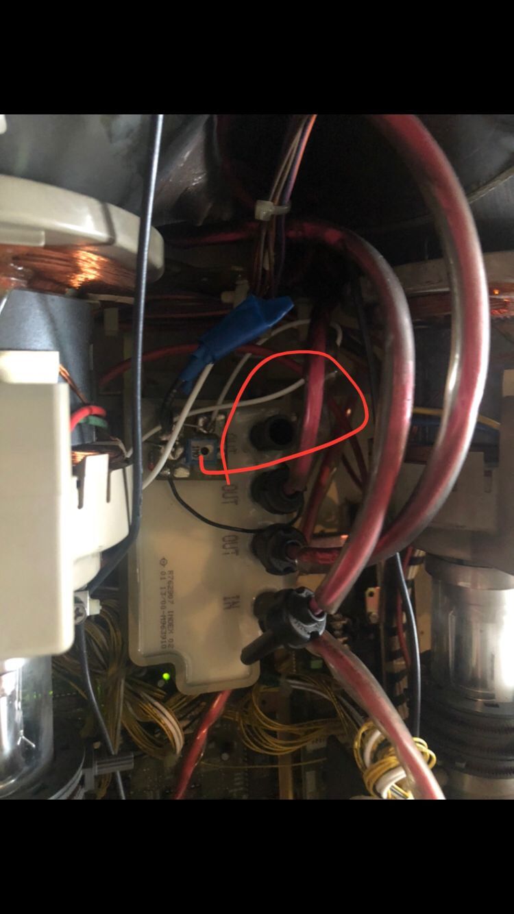

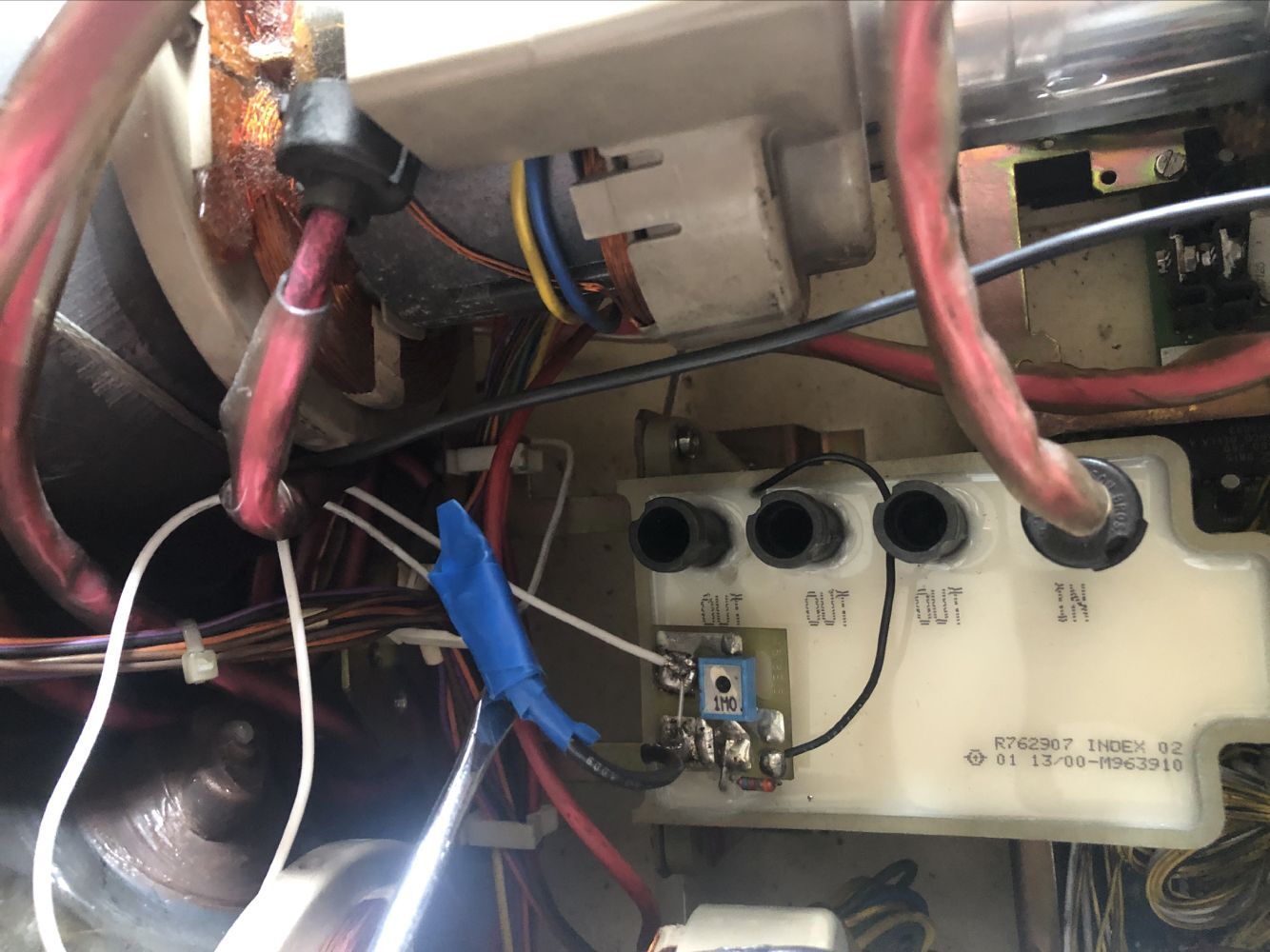

I may have made a mistake. I connected one end of the HV splitter to the casing. this is the most original installation method of 708mm, When I removed this line from the casing, and disconnect the HV lead going to all tubes, ‘hold down EHT’ fault LED light will changed from red to yellow,but the left end of the upper part of the machine made a sound,is this what Curt said about ' a short in one of the tubes'?
I don't know how to find the fault?
Thanks!

Posted: Fri Apr 22, 2022 3:50 am    Post subject: Barco 708MM “HOLD DOWN EHT” fault
This is the line

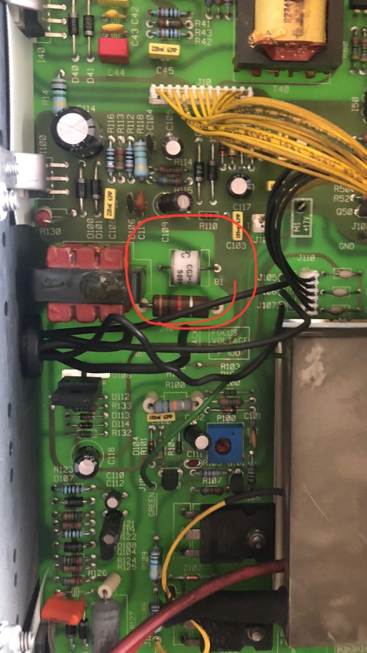

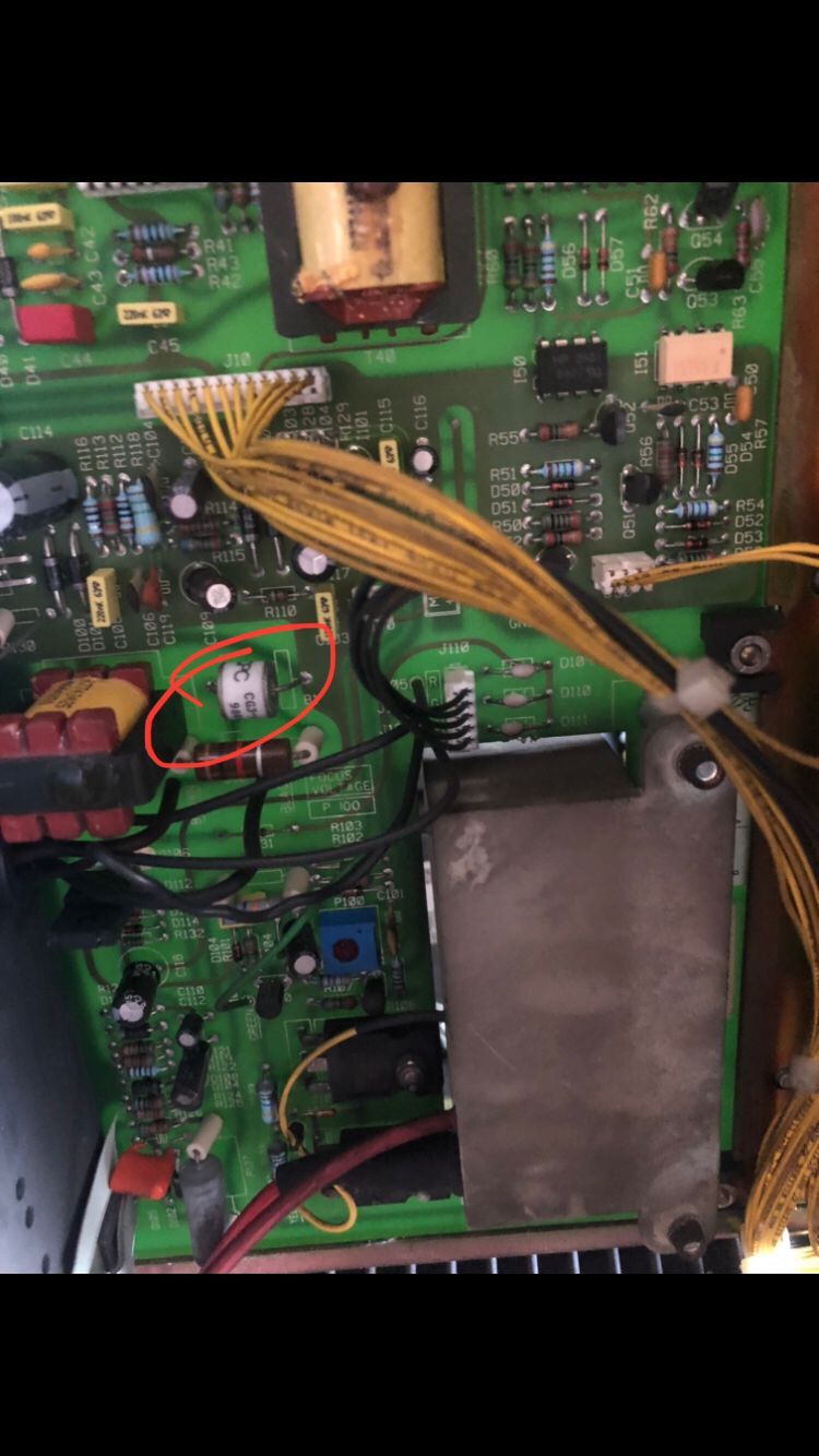

Posted: Fri Apr 22, 2022 4:57 am    Post subject: Barco 708MM “HOLD DOWN EHT” fault
This is the element that makes a sound

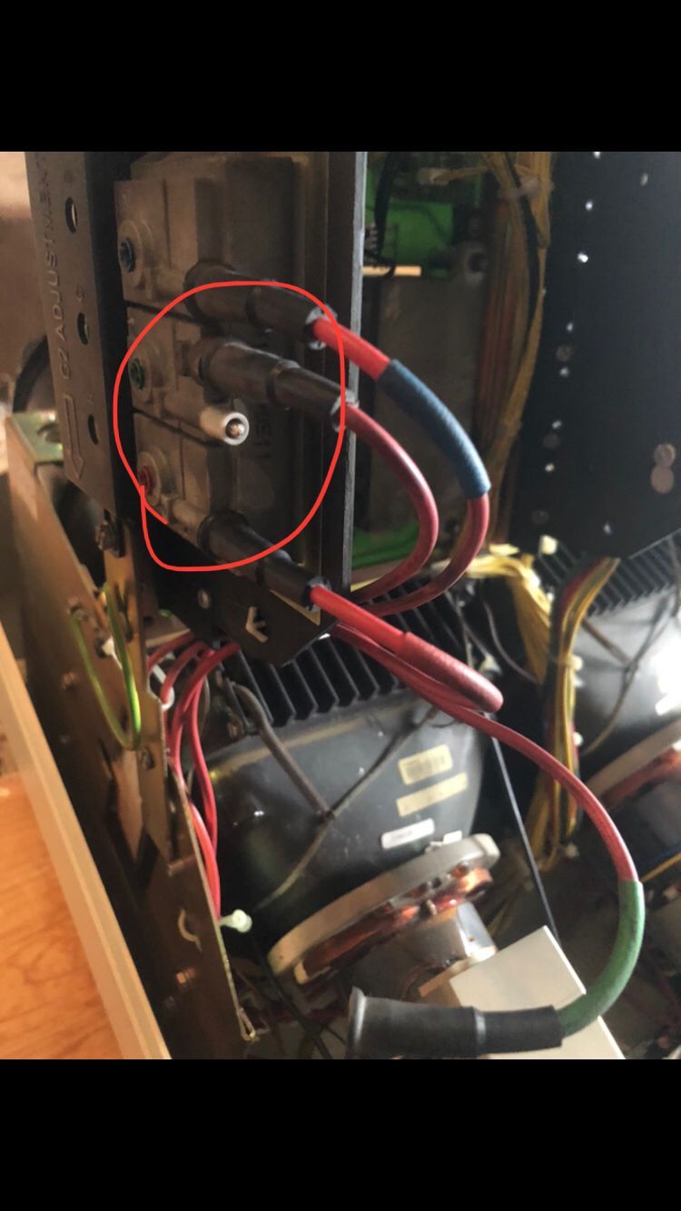

If the lead lines of all the tubes is connected to the HV quadrupler, the LED light will show ‘hold down EHT’ fault.

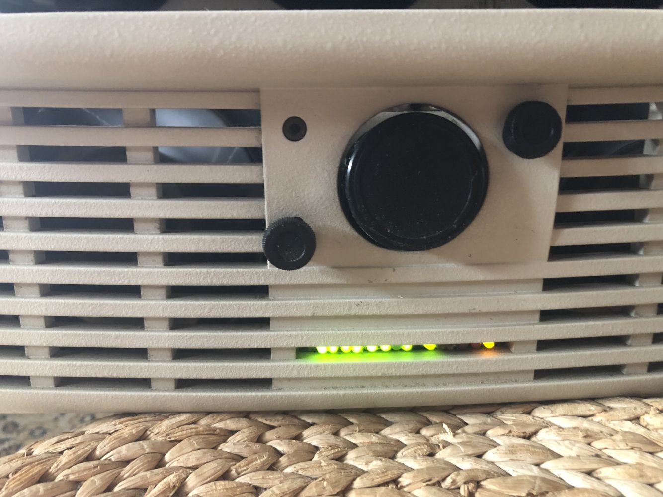

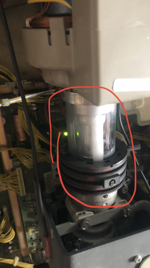

Posted: Fri Apr 22, 2022 5:44 am    Post subject: Barco 708MM “HOLD DOWN EHT” fault
This is "Disconnect the HV lead going to all tubes", LED light is normal,but the element that makes a sound ,and the neck of the green tube flashes
 Filesize:  168.15 KB
 Viewed:  6027 Time(s)

Posted: Fri Apr 22, 2022 6:14 am    Post subject:

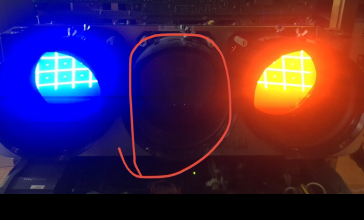

Posted: Fri Apr 22, 2022 6:58 am    Post subject: Barco 708MM “HOLD DOWN EHT” fault
I only disconnect the G2 line and HV Line of the green tube, after starting up,the 708mm running is OK

Posted: Fri Apr 22, 2022 11:56 am    Post subject:
Very regret,fault found, I broke the green tube while moving the machine.....Does Curt have the green tube? Thanks!
