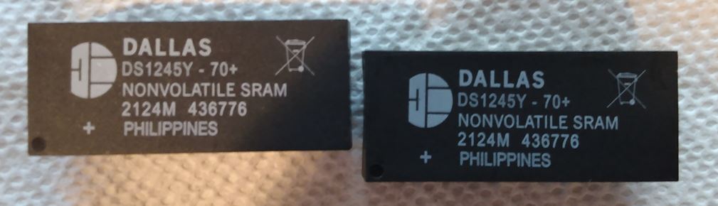

Well, my two Dallas DS1245Y-70+ chips arrived today from Mouser. I guess no new flashy red Maxim logo as shown on the Mouser page. Looks like these were manufactured in 2021 at about the end of June (3/4 of a yr ago). Of course the internal battery isn't connected electrically until chips are programmed for the first time.
Now just waiting on the programmer.

Actually even when programmed, you can't measure the internal battery from the outside pins. At least that's how it worked with all the old ECP sets. I tried..

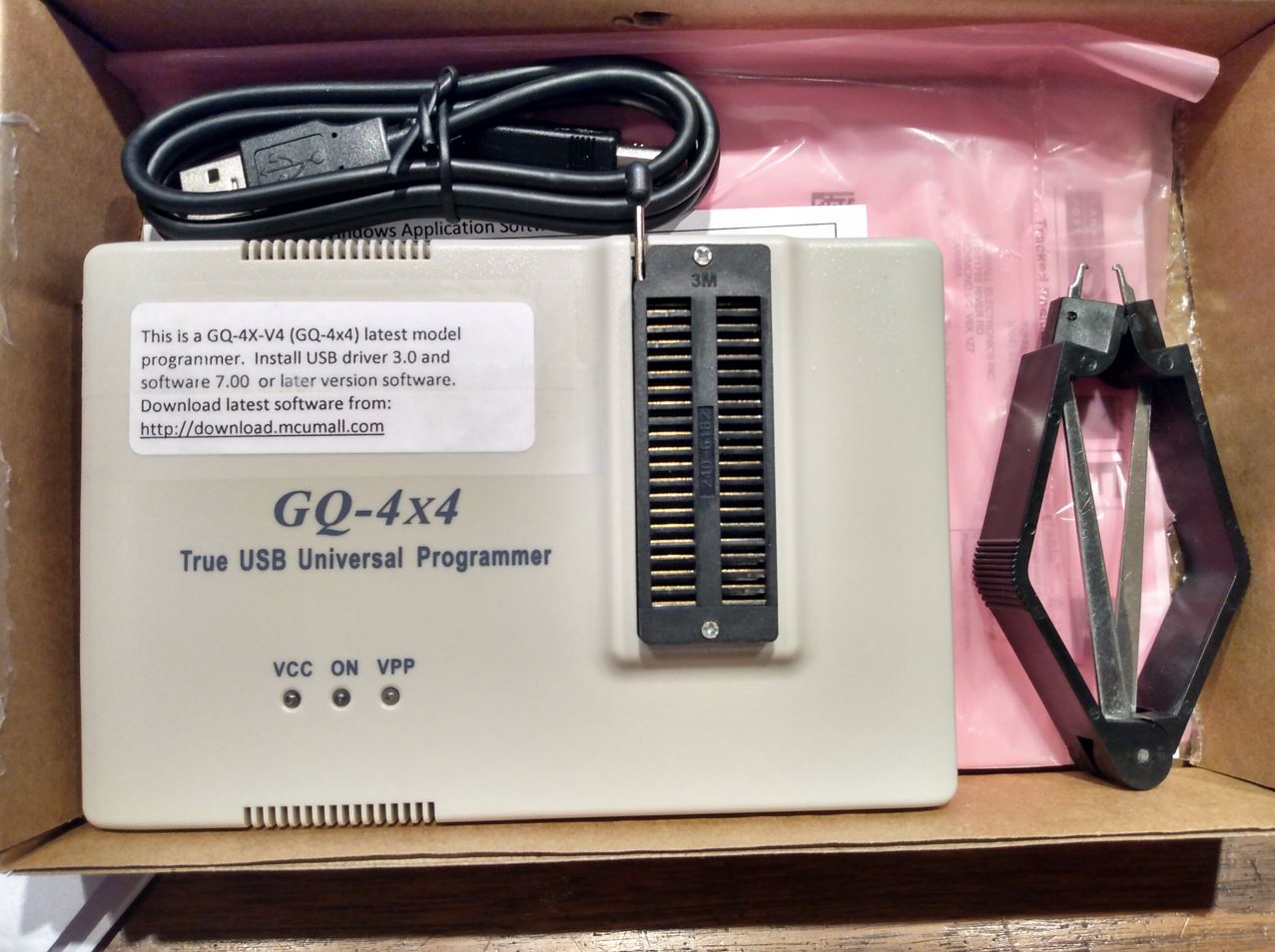

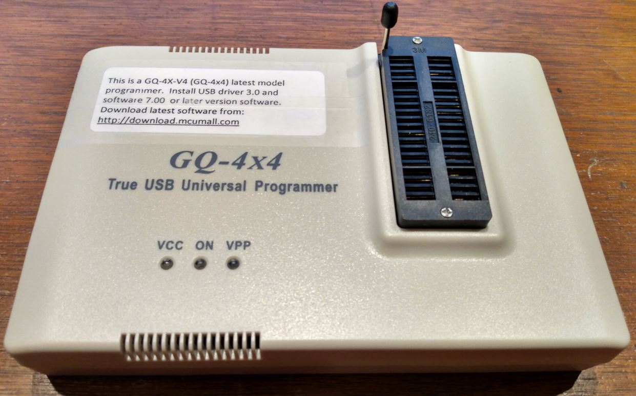

Well the EEPROM programmer FINALLY arrived from mcumall.com in Canada today. Canada post hands it off to USPS, took much longer than I thought it would. I'll post more about the procedure and how it went towards the end of the week.
Steve
