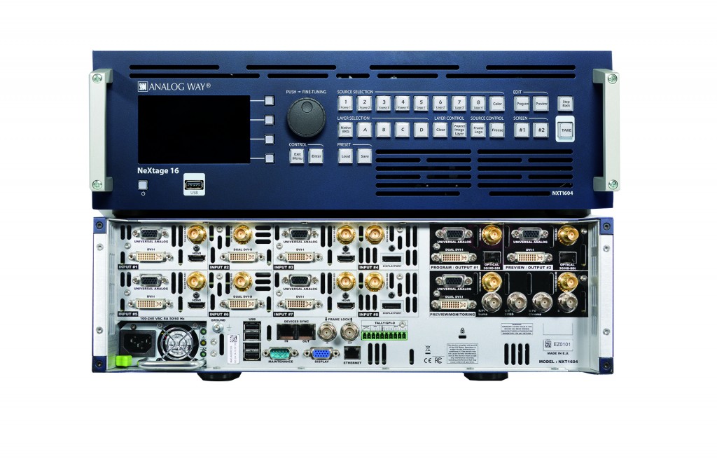

Posted: Wed Mar 23, 2022 2:46 pm    Post subject:
The Radiance may work if you hang a 4K flat screen on the output; what I need is HDCP stripping.
DVX8022 specs "Line frequency up to 130khz." on the input. If 4k is twice 1080P/60 that would be 134khz. The Analog NeXtage units would handle it but possibly still need HDCP stripping.
One may also need to take a class how to set it up!
