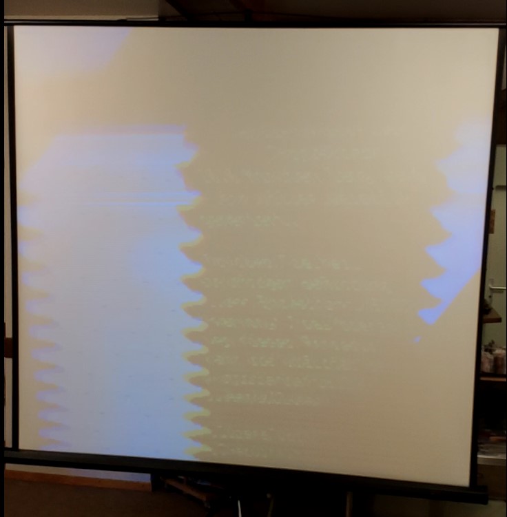

i believe in the video it is trying to display a menu. i tried again pressing the adj button and i get the same results. if i press it again it goes black but i can still hear the high frequency sound being inconsistent. so, it’s trying to display a menu (when it hit the adj button) but it’s very wobbly and it keeps flashing on and off.

so, i tried it out but i don’t believe that’s the problem. it starts up with or without a missing card. however, i have noticed that the weird inconsistent high frequency sounds stop when I’m changing inputs. so, if it doesn’t have to display a picture, it sounds normal. that’s why i think it has something to do with the Sync+Vertical Deflection Module. the red led on it flickers in sync with the picture and high frequency sound (when I’m trying to display the menu). but mainly when changing inputs, when the card is presumed not in use, that’s when the inconsistent high frequency sounds stop acting up and it sounds like a normal crt until the input is changed.
is there any way to check if the Sync+Vertical Deflection Module is working properly?
Posted: Tue Dec 21, 2021 5:08 pm    Post subject:
Disconnect all inputs, and fire the set up. You should get the onscreen menus and test patterns clearly. If not, and it's still similar to the picture you posted above, then it could be:

with everything disconnected i get the picture that i posted above. do i have to presume that all the components you listed are broken or is there a way to find out which one it is?
Posted: Tue Dec 21, 2021 5:18 pm    Post subject:
At this point you have to do board swaps, as this is a problem I've never seen before. I will have some of the boards if you need them, but I am almost out of 808s parts.
