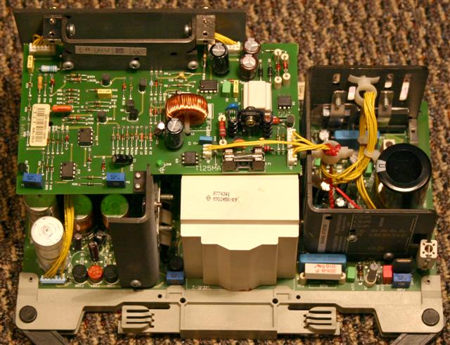

PWC= SMPS,Main Power Supply

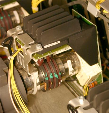

What's a 'power amplifier tube'? Do you mean a power transistor on the RGB Output Amplifier?
RGB output amplifier looks like this:

err, wait, I think you're only talking about the main SMPS (R7621706) right? This here:
See all the various board names here: http://www.curtpalme.com/Zenith1200_Layout2.shtm

yes, the main SMPS has failed, its number is R7690205. the power amplifier on it was broken.

I have two main SMPS boards (a R7621706 and a R7621705) , can they replace R7690205 board on barco Cine8?
Posted: Tue Sep 07, 2021 1:45 am    Post subject:
Sorry, no idea. Someone with knowledge about the differences will have to chime in.
You can also try searching the forum for the various models to read about the differences. For example, this thread came up:
https://www.curtpalme.com/forum_archived/viewtopic.php@t=36346.html
Posted: Tue Sep 07, 2021 1:57 pm    Post subject:
I believe so. Try it.
